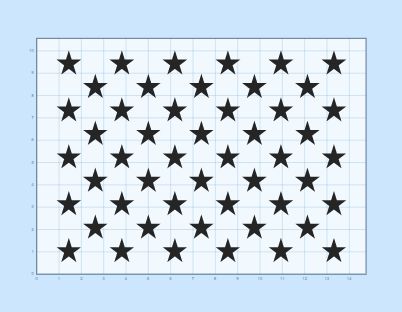

New to x-carve and trying to figure out what I am doing wrong. I am trying to the 50 stars for the union, on easel I have on the x-axis 15 inches and on the y-axis 10.5 inches, once I go through the steps when I hit carve it goes to about the 7-inch mark instead of 10 inches and it doesn’t plunge down to where I want it and creates small stars. Can someone please help me out?

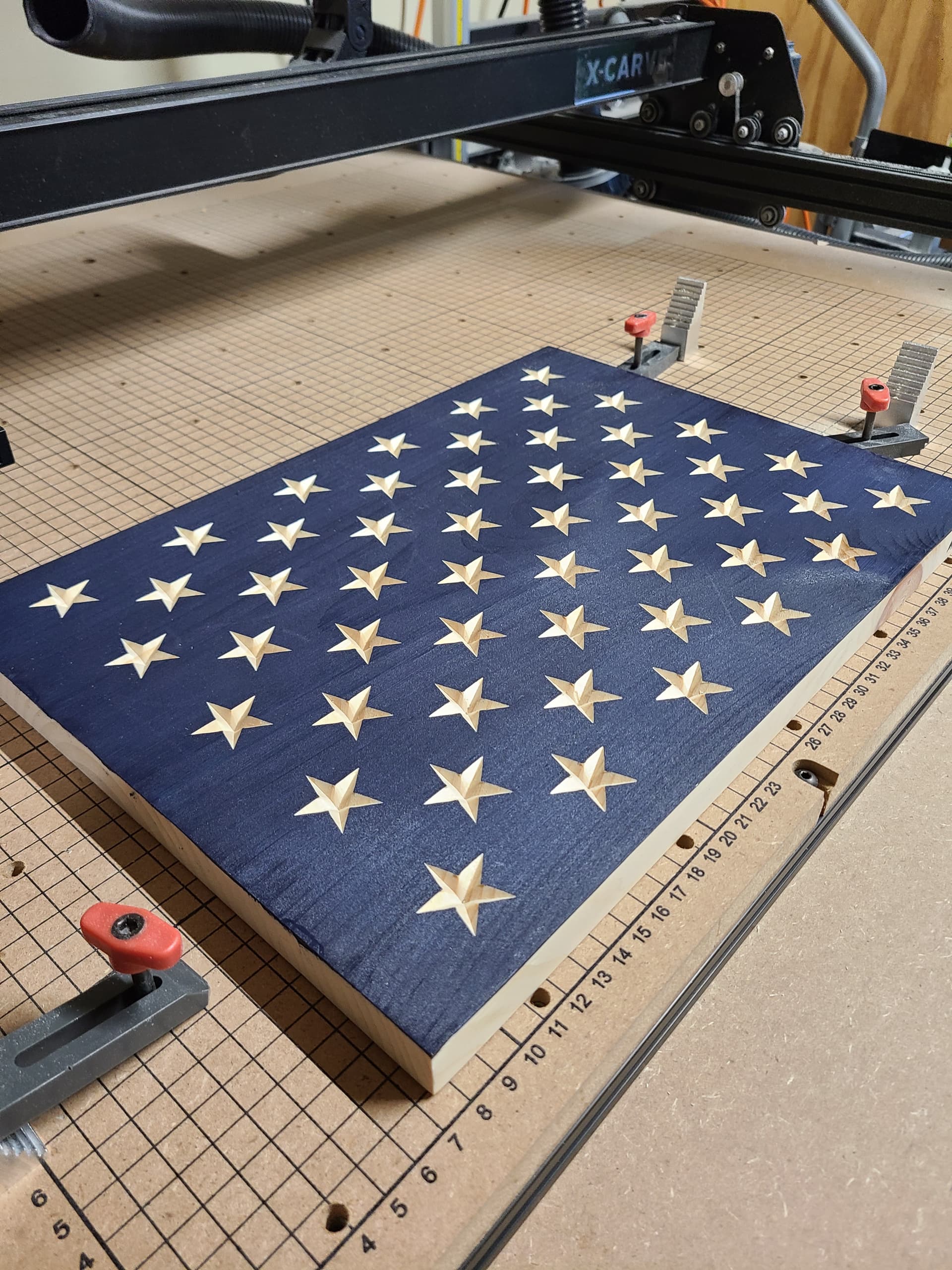

I ran it through the entire carve just to see where it’s at and this is where I’m at now. Still coming out short on the x-axis and some stars looking weird.
Um, I made this video before noticing your X belt issue… this is not how this belt is supposed to be ran…
It should be routed Under the black plastic pulley and yours appears to be routed over it… or some other way I have never seen b4… Here’s some good photos to show the proper placement…
Here’s My take on your Carve and what might have caused part of it… that Said, I recorded this Prior to noticing the belt routing issue…
Here is my video on Shimming to get the top parallel, which I sometimes HAVE to do for unions when Surfacing on the CNC is not an option… I’ve only had to do this about 10 times and it resulted in perfectly crisp star points…

I definitely missed that! Yea I just have it on the pulley instead of under, up and over and under. It might have been when I was fixing it a few times and missed it. Thank you for that!
I used the 90 degree 1/8 shk bit. The first star on the top left I ran it twice so that’s why it looks like that, I didn’t do roughing and I set my XY at the corner and not where the star was. Thank you so much for helping me. I will look into the link!
with the right grbl settings now and the belt routing fixed, you should be good to go, just might want to surface the workpiece or shim to get the top perfectly parallel to gantry ![]()
