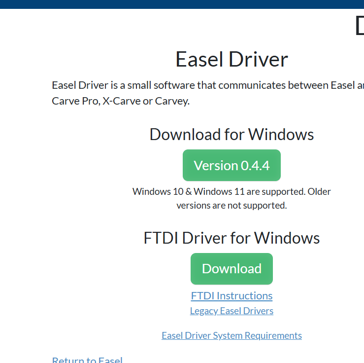

Don’t forget Easel has two driver software items that you need to install as well.
done and done,
both of the below drivers have been downloaded and installed, as stated prior. I have also downloaded the ch340 driver from FA, and installed.
