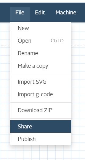

Share your Easel file so we can see what is going on
File->Share->Shared with Link-> copy URL, click Save and close, paste URL here.
Apparently I cannot do this from my smartphone. I will get to my computer shortly
The project is still not shared publicly. You will have to follow the directions from HaldorLonningdal and post the link that shows up on that pop-up screen.
