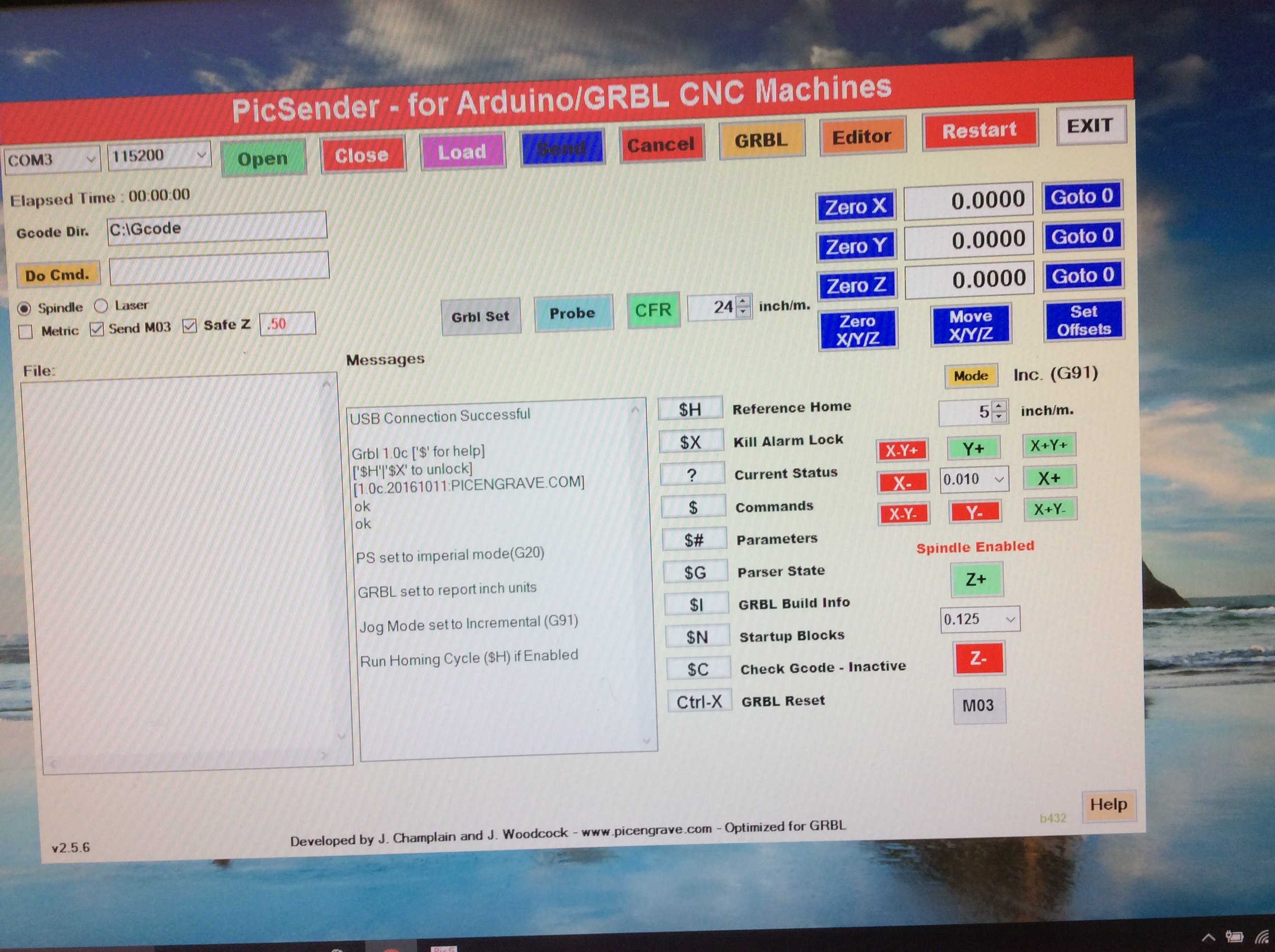

Finally, if you can capture a screen shot of PicSender just prior to hitting Send and another just after hitting Send.

Okay, I was using the trial version of Picsender. I now have the full version loaded. I will try again and post my results. Stay tuned.
Thank you Michael. Demo version limitations explain your problem.

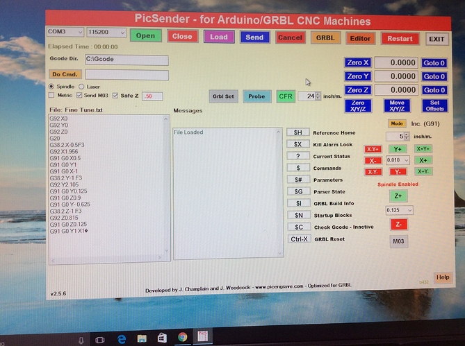

Okay I went back in to re-zero and now the code that I saved will not work. What am I doing wrong??? It tells me Line#15: Alarm Lock.
Did you home your machine again?
yes
Try the $X Kill Alarm Lock button and try zeroing again.
I did but the machine tripped my limit switch which is in the opposite direction.
Okay< I shut down and restarted. I re homed then I loaded the Fine tune code then hit send. the machine triped the limit switch and I get this from picsender: Line number 6. Alarm probe failed. Not sure what is going on.
I donât know either. Calling @CharleyThomas & @JohnChamplain
I m also getting GRBL response: error: Alarm Lock. This is really getting annoying.
I cant believe that it would be in the wiring just for the fact that I have done 3-6 projects before I loaded Picsender and did not have a problem. I loaded Picsender so I could zero the bit using the Triqueira. Even after I get the program to zero when I shut down or change the bit I am unable to get the program to zero again with the code that was created by the Triqueria.
Futher more I am unable to get Picsender to work at all now.
This is an alarm message direct from Grbl, not from PicSender. It is usually associated with a shorted probe when beginning a probe move. Make sure you are clear of any limit switches and your probe is not shorted to ground when you run Charleyâs code. Sometimes, touching the probe with your hand can cause the alarm with some machines with a grounding problem. Your body can act as a ground shorting the probe.
Please describe this better. Do you get any error messages? Does PS connect OK? Can you post a screen shot if PS connects or not?
