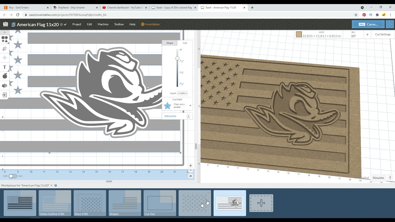

I am trying to design something similat to this RN symbol on the flag file I have. How do I get the stripes to stop at the edge of the logo. I have tried to break the stripe and “hand draw” the border in but it doesnt look even. Very new to this, may be way above my skill set for now.
You’d need to use the combine function with an offset vector of the design.
Here i made a little video showing the process a while ago for someone else… this shows the process …
This is EXACTLY what I was looking for thank you Seth!!
