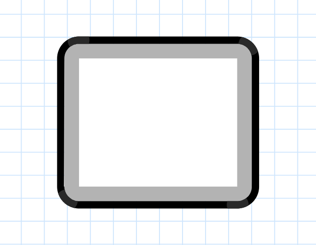

Nevermind. Figured it out. You do inside shape and set fill to 0 and set it to front… then you use offset app to make offset copy thickness of your box You fill is down to the depth of your rabbet you want. Then you copy the outside shape and paste in same place (have to select copy and original and do center alignments). Set the last copy to outside cut. Here is a link to the quick shape I did. Note you end up with three pieces.

Thanks. So you did a ledge in the box. cool idea
Thanks. In your or my procedure is Easel smart enough to do the rabbit before outside cut?
