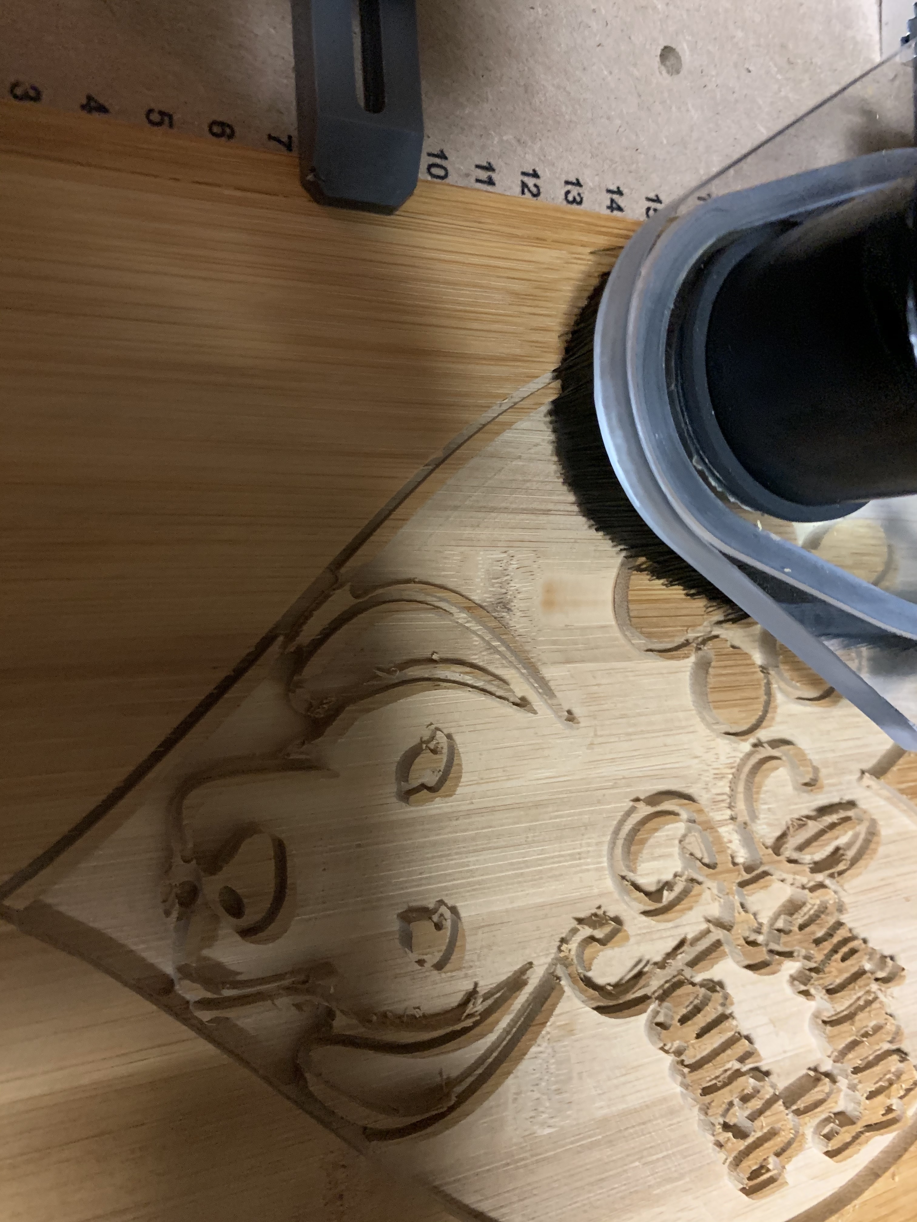

The detail carve is off by like a mm. It just starts carving in the middle of my letters, knocking out parts of fine passes, making outside edge large on one side, not touching the outside edge on the other.

The line on the left is not suppose to be there, you can see it has torn up my lettering and my dog image.
