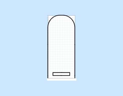

Here is the project. For whatever reason I can’t get both sides equally rounded. I have used a circle here and covered the bottom section that I don’t need.

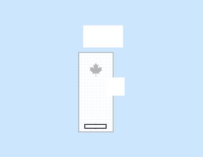

This is what I am attempting to build. I have done some by power tools but want to see if the CNC can cut these as I have friends wanting more of these chairs.

Here is one with the back and seat. Note that this project assumes (based on the design referenced) that you are going to have 10" of stock sticking out the front of the machine (the notes say as much) since the design is 36" in length for both pieces, but you only have 26" of stock in your project (presumably due to using and X-Carve 1000x1000).
If you want the top edges of the back to have a much smaller radius than what is shown then that is an easy change. To me, it looks like the top of the design being referenced is just half of a circle anyway. The same thing goes for the seat’s front corners; I just cut them off just as the design showed in your link, but this would be a straight forward change.
Also, you might have to increase the width & height of the cutout where the seat slides through for a good fit. I made the design exact which we all know would be tough as nails to get the seat in…
