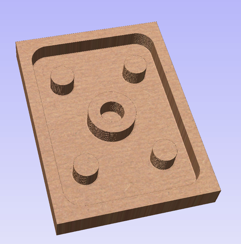

this is a 6.5 wide x 8.75 long x 1" thick piece of pine. When testing materials its best to not skimp as you might make mistakes so give yourself room to explore many different CAM strategies
okay so basically we are going to make a pocket .75" deep with a couple circles and 1 circle with a pocket inside of it and run a test to test edge finishes please note that floor finishes are something we can tackle latter
this test really is only to test surface finish of 2d carving straight off the machine so there are no need for things like slots or complex shapes but we do want to be able to test the tools with the grain and across the grain

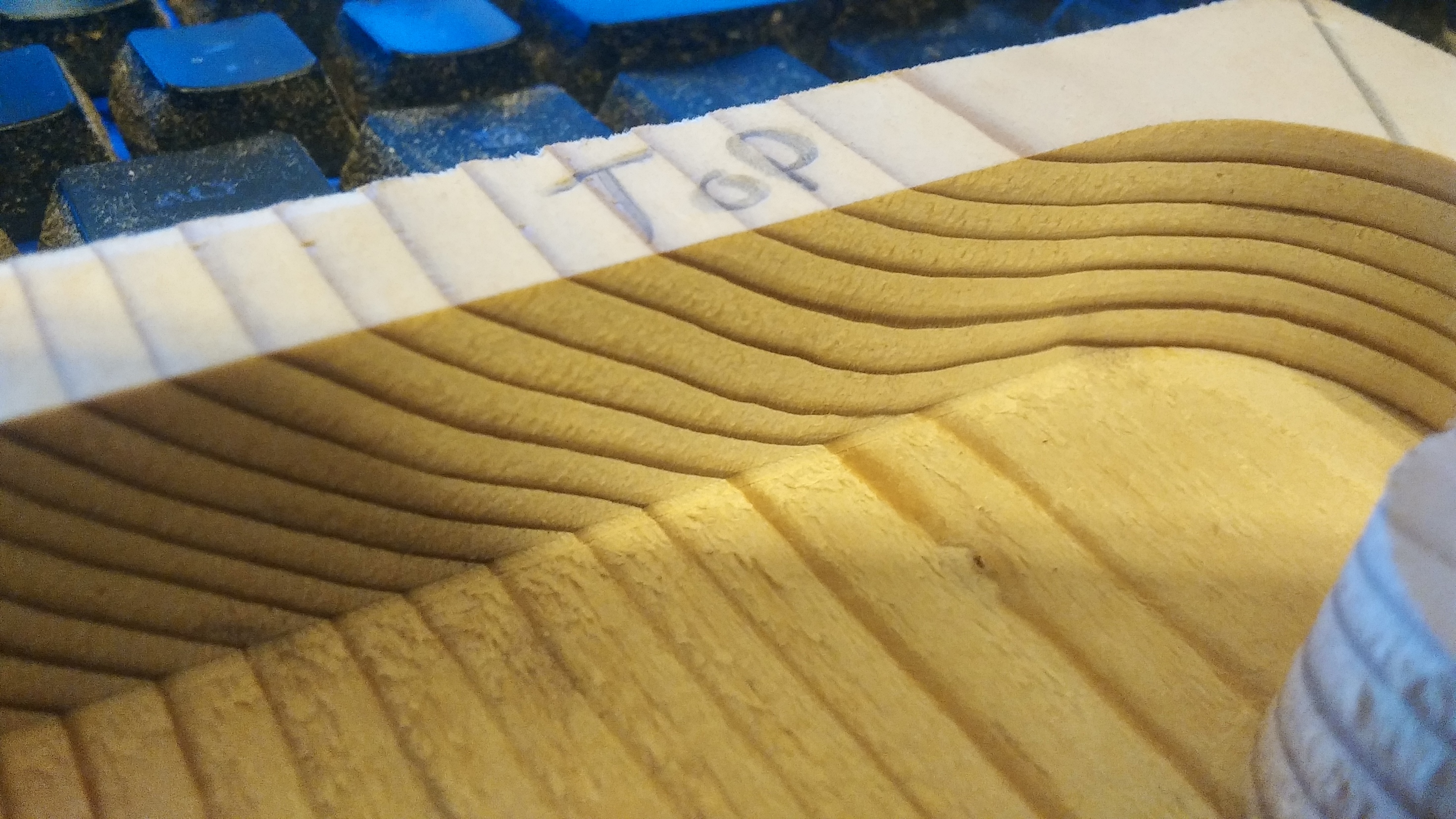

Here is what the piece looks like overall after all machining was done there was not sanding or post processing done

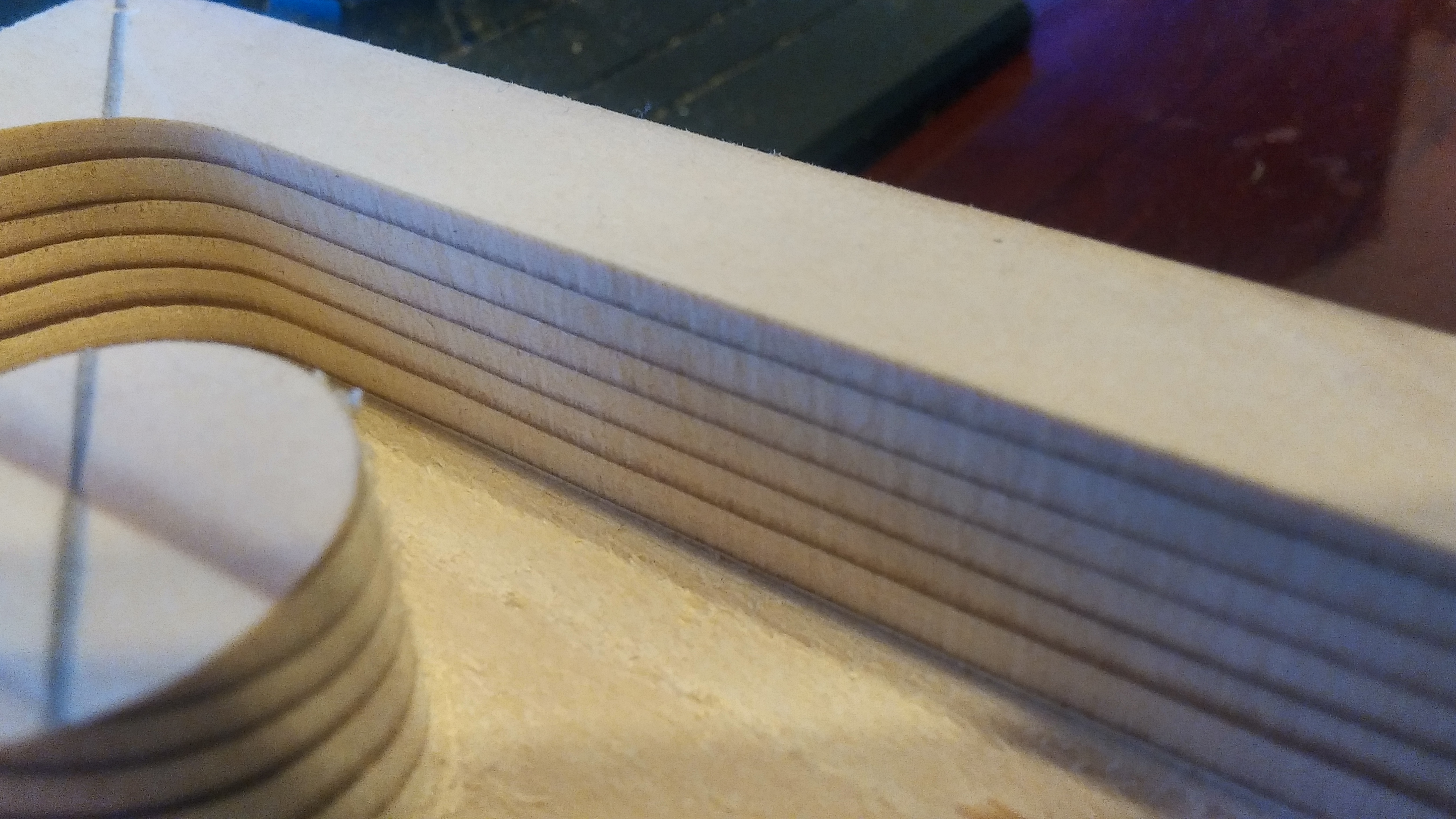

Here I am showing with the grain cutting I used climb cutting here as well and the surface finish is glass smooth and no tear-out

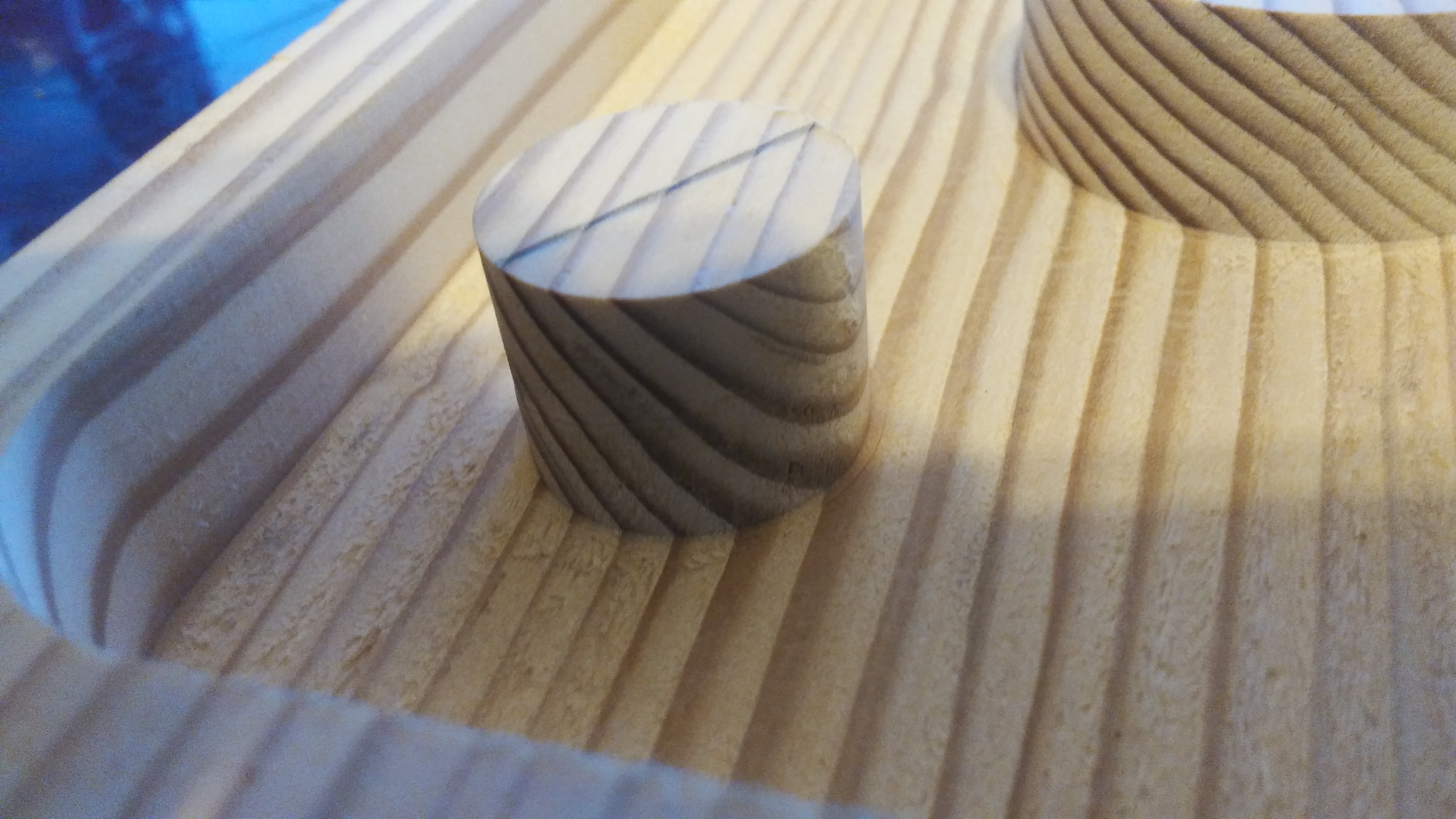

So on this circle I used climb milling on the outside profile and you can see that we have fuzzies but these can be taken off with a quick 220 grit paper
This was the best out of them all no tear-out and no fuzzies I used conventional and ran finishing at full depth
