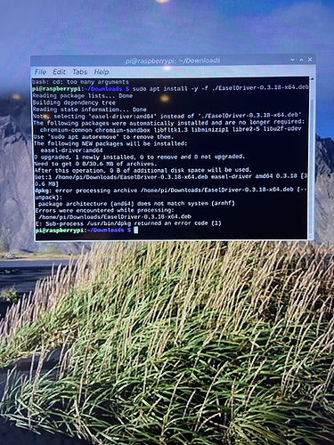

Hi guys I’ve recently set up my Raspberry Pi 4+ however I’m trying to run my cnc 3018 off the Pi via usb lead into the Pi from the machine. When I’m on Easel it and setting machine settings up it asks me to down Linux, windows or Mac driver so I download the Linux on my Pi open it and when it’s extracting the files i get a error message can anyone help me?

when you download the Linux driver it is compiled to run on a processor that has the X86 instruction set ā€œthis is a type of processorā€
when you download the mac driver is is compiled to run on a PPC instruction set ā€œthis is also a type of processorā€
when you follow the directions on the post you will extract the driver source files and compile your own driver for a ARM instruction set ā€œthis is the processor used in the Raspberry Piā€ only then will you be able to get it to work. ā€œtalk to your systemā€ the process is steam lined by @SamyKamkar and he has made this very easy to do.
