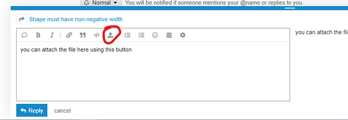

you can attach the file here using this button and I can see if I can get it to work on my end…

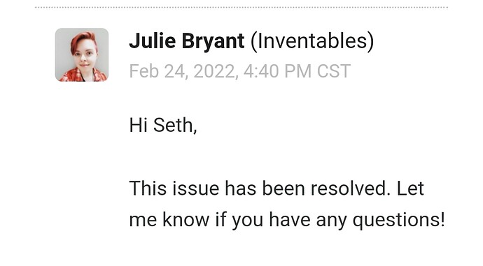

Should be fixed guys!
I just got this in my email, but I’m out right now…
Maybe one of yall can try your file again
PS, thank you for getting back to me about this Julie
