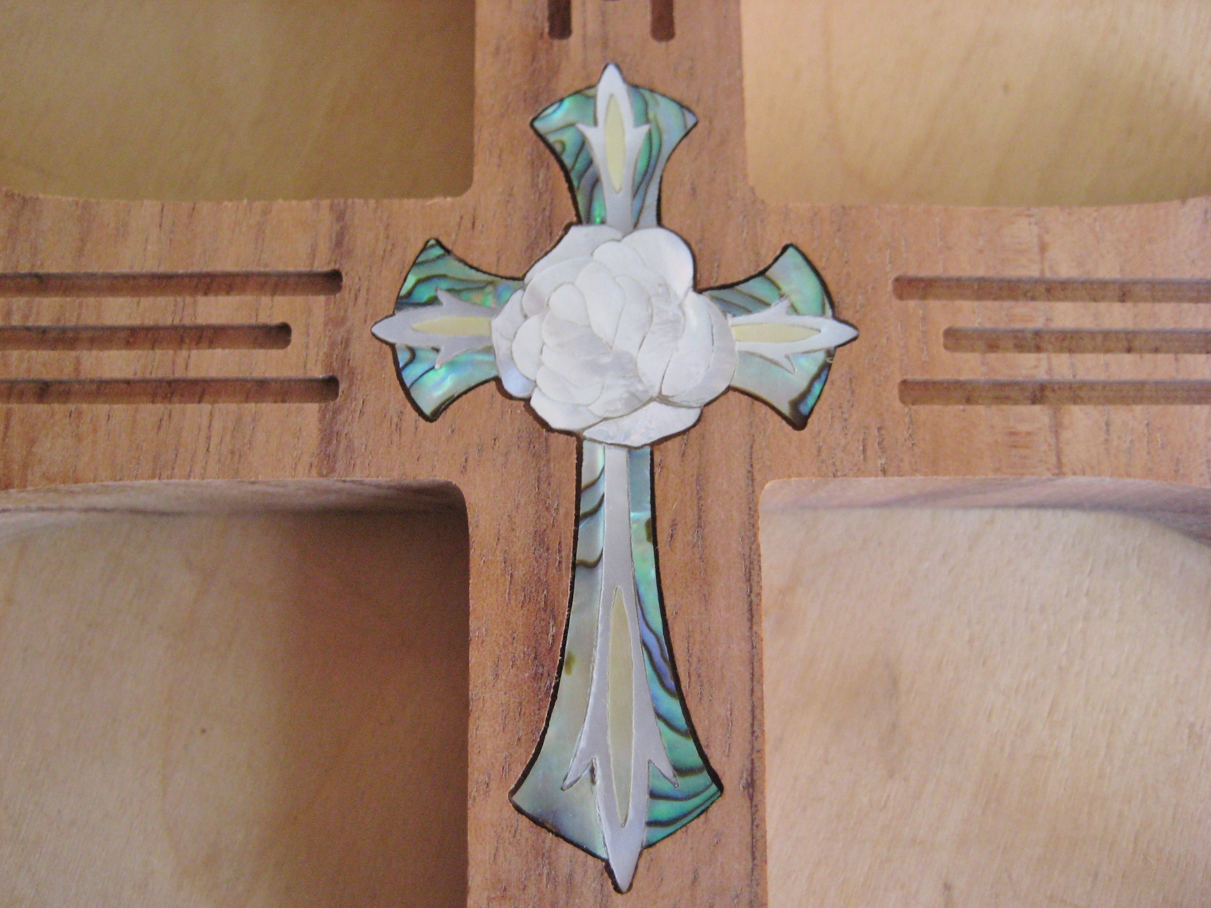

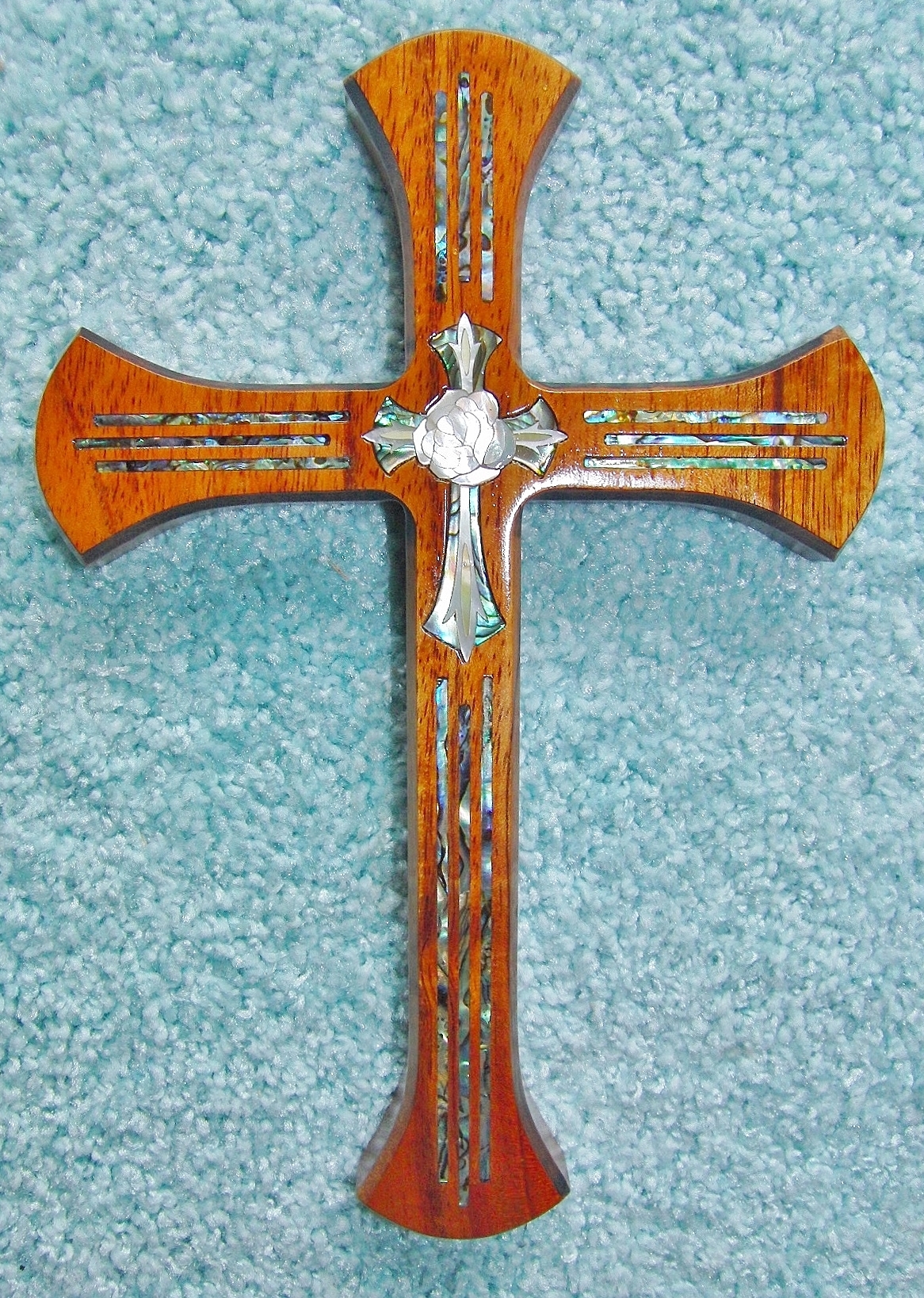

Koa wood cross with shell inlay (Abalone & Mother of Pearl) made for a friend. Cut inlay pocket a little larger than usual to have a dark outline and more contrast. Worked out well.

I cheated and bought the shell cross piece already made and strip cut the Abalone sheet on the table saw.

How did you measure and cut the pocket so exactly to fit the shell?
I scanned the piece and then created a vector outline using CorelDraw.
Interesting, I have not tried that before, how do you keep the scale correct?
Just scanned @ 100% @ 600dpi and imported into Corel. Stayed at original scan size.
