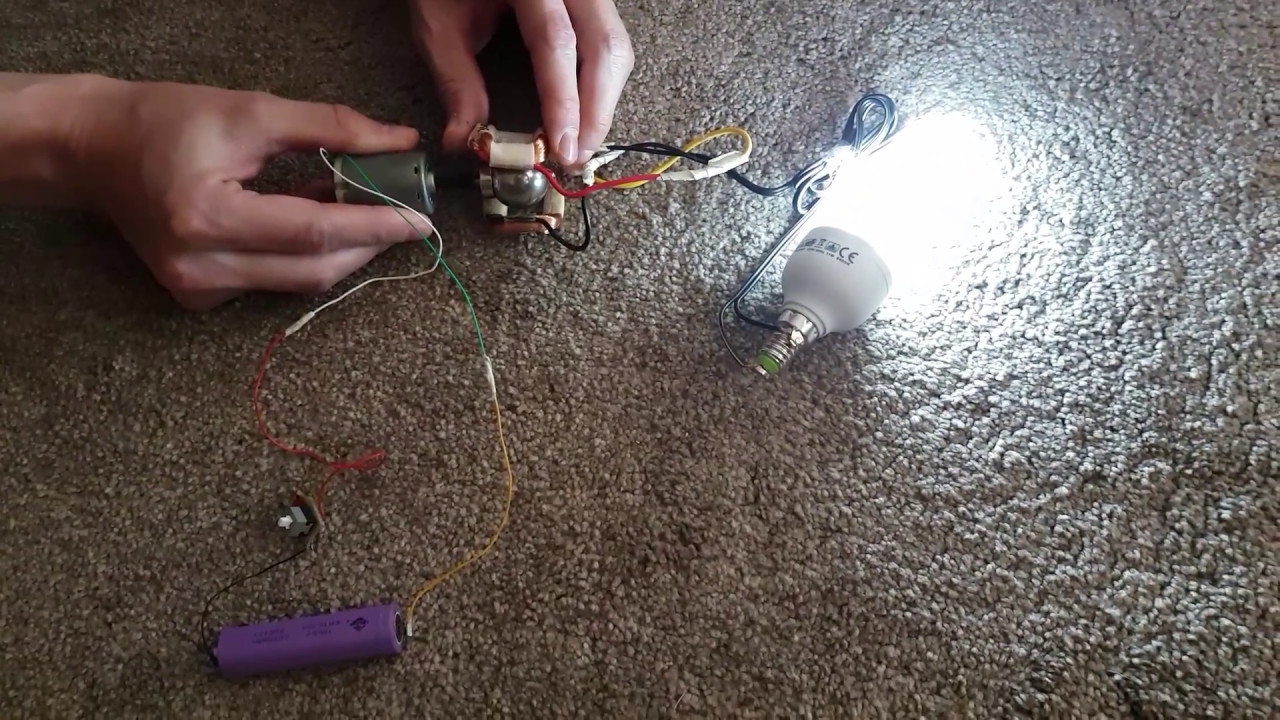

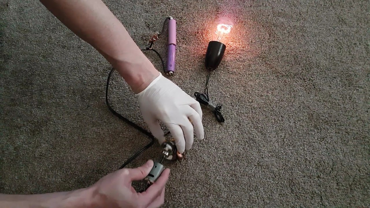

small AC generator 230 V using a single neodymium sphere 13 mm diameter, a coil without core from a 230 V syncronous motor ( A4 laminators or microwaves turntable motor), a 3 V DC motor (inside electric car toys), and a battery.

Remove the magnet from the neodymium screw pot metal case
Remove the coil from the syncronous motor
Attached the screw pot metal case to the dc motor ax through the plastic connector
Create the simple generator holder
Conect the wires to the dc motor and battery through the power switch.
Conect the bulbs using wires to the coil output ( in Ac current it doesn’t matter the conection order, only in dc is very important)
Assemble all the components (small generator diagram)
