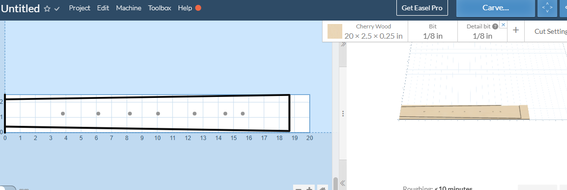

Thank you for your reply. Not sure hw to do screen shots. I designed up a new project and again tried to Choose a v-bit. There are 2 buttons on the menu to choose bits now, the first one has only manufacturers bits and below it are other bits which can not be chosen. The second button has a choice of bits but only combines it with rough cut and detailed bits. I try to choose a v-bit and when I start the check-off process just before carving it shows a 1/8" bit for rough carving and a v-bit for detailed carving. Why??? I only want to carve with a v-bit. Why so complicated? What happened to simple and easy and efficient?

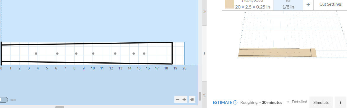

Did you click the detail bit off? Click the little x to close the window for detail bits. I never use detail bits and just close the window.
To do screen shots and you are on a PC…You can hold down the shift and prtSc keys. Paste it into paint. Crop it or do any editing and save it with a file name. The above is an example of that.
