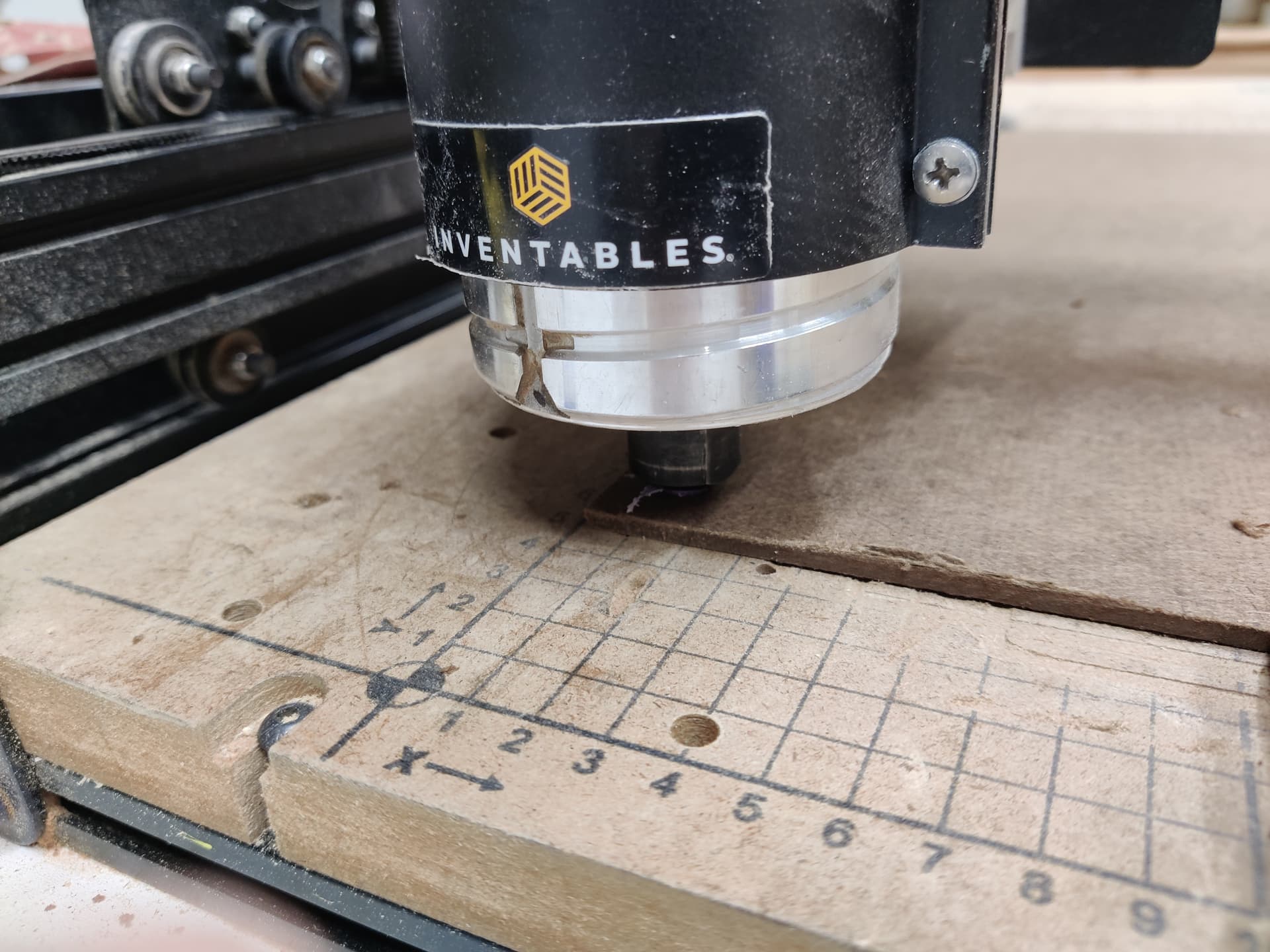

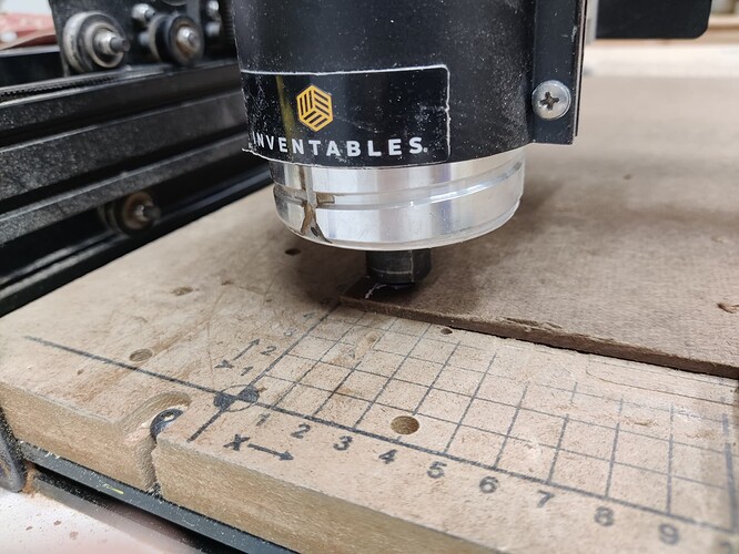

This just started a couple of days ago and I cant figure out what’
s happening. It will keep and pushes the gantry up.

When you start the carve the spindle goes straight and continues to go straight down until I turn it of. It pushes so hard that the gantry starts to rise up. It will keep going until I stop

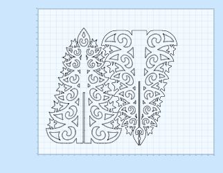

Can you download the file here so we can take a look?
It happened on two other projects on mine as well.
Christmas Tree.zip (441.5 KB)
Can you download here using easel.

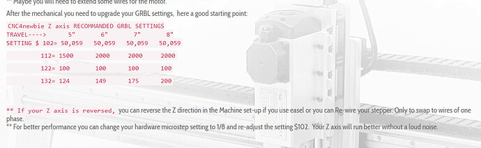

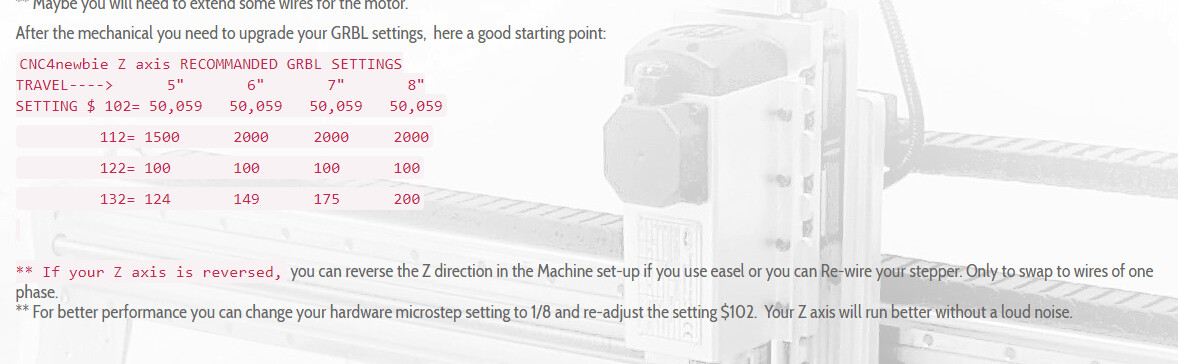

No I have one from cncnewbie. I put it on a couple of weeks ago and it has been working fine up until yesterday. When i set it manually it didn’t plunge but it disregarded the depth of cut I set it at.

Ohh, you need to adjust the $3, $102, and $132 for a non- stock z axis
