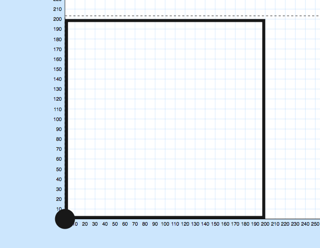

Square or Rectangle with"Internal Radius" Corners
I’m trying to create a plaque with a shallow pocket that has “internal radius” corners as opposed to “external radius” corners that the square/rectangle tool in Easel provides.
I’ve tried entering negative values (wild guess!) as a corner radius. I’ve also tried using the circle tool to “overlay” each corner and then do a combine, but the results were not as expected.
Just wondering if anyone can set me on the right path???!

Two rectangles:
  • One (the larger one) set to desired depth.
  • The other set to zero depth.
Both rectangles can have radii specified.

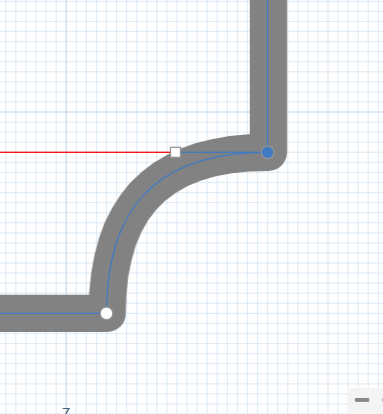

I was struggling to figure this out too. This may not be the best way. My only issue is getting the exact same internal radius on all corners:
Once the square is put into a cut on path and a radius is set, you can double click and adjust the corners.
