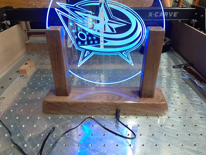

I use a 60° V bit (whiteside 1541)
Depth of cut is .02" with a feed rate of 100 IPM. and I never go over the lowest speed setting.
The round light standoffs in the picture are from outwater supply.
I also use light strips and place them in the base under the sign.
It all works very well.

Thanks Jan, so on the round one are the LED’s wrapped around the edge?
I think they are tucked into the stand-off that hold the acrylic.
Check out the link that was provided.
Hi Steve,
The round one has the stand off lights (from outwater supply) in the two upright post that hold the acrylic.
The wires run down each post to an electrical pocket in the base.
There they are connected to a 12 volt female plug that goes through the back of the stand.
The Harley sign has an LED light strip in the base under the edge of the acrylic.
I don’t know what software you use, (I use Vectric desktop) but if you want I will send you the designs.
I hope this helps.

Thanks Jan, no need to send files was more interested in how you lighted them. Thanks for sharing!
