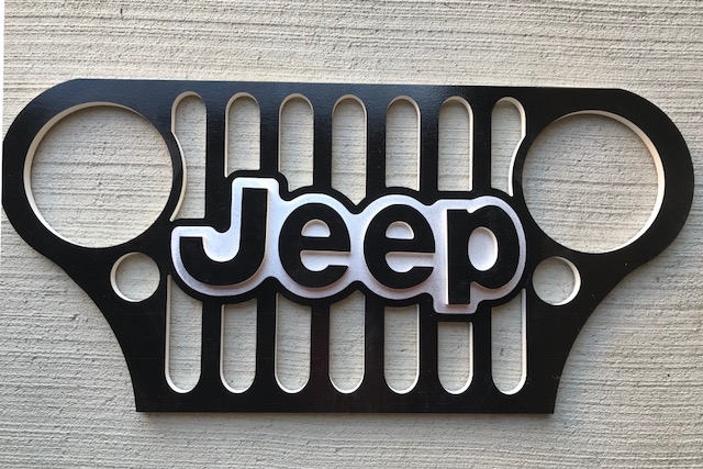

All your projects look great - love the Jeep flag!

Here are a couple more I have done.
The Reds Logo is being donated to my company as a fund raiser in support of plant employees that need some help at Christmas time. We as a facility adopt 15 local families and the employees buy gifts in support of that cause. Last year we also adopted several MCC family’s and will be doing it again this year.
The Logo took 1:15 with with a 1/8" end mill and over 4 hrs with a 90 degree 9/16" V-bit. Easels estimate was 2:15 minutes for that step, that is the second project i have done were the estimate wasn’t even close. Took an additional 15 minutes with the 1/8" end mill to cut it out.
Overall I am very pleased with the outcome.
That logo is sweet! It’s made out of the PVC board? If so what are your finishing steps? Also is the UK logo made out of the PVC board or MDF?
Yes all PVC board paint first then carve. On the Bengals I sprayed it black, put on Oramsk, Carved then sprayed the orange. Had some picking of the black when I peeled the Oramask to touch up still need to work out that wasn’t to bad most people would never see it but I do.
