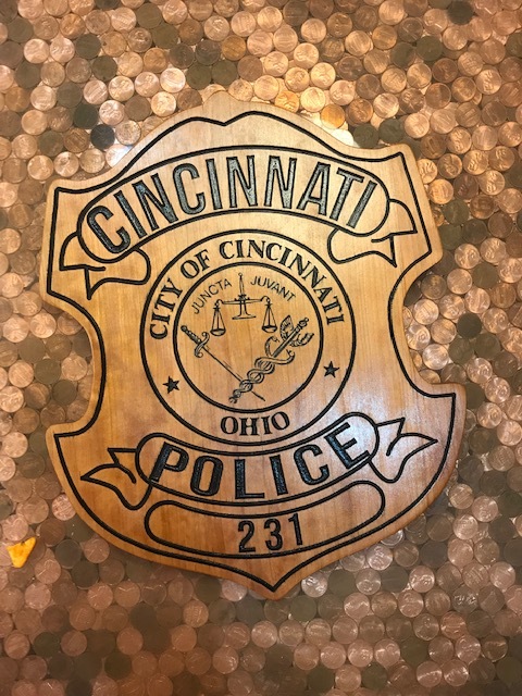

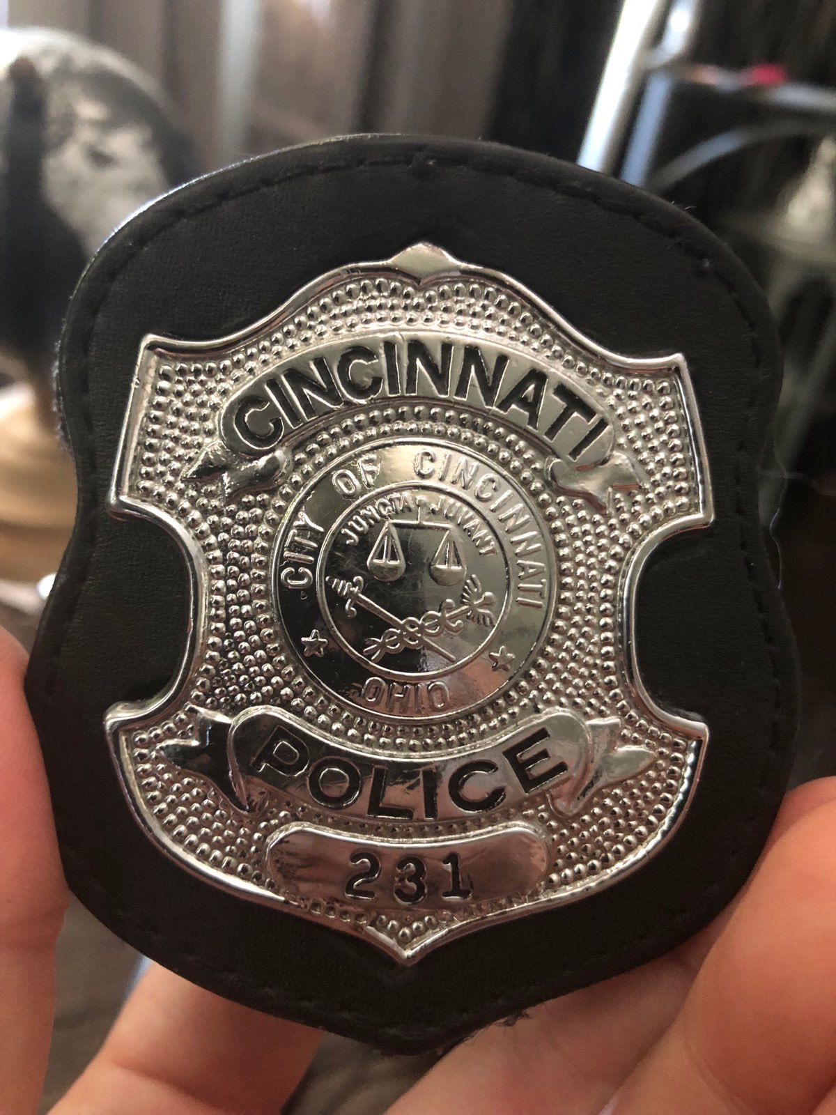

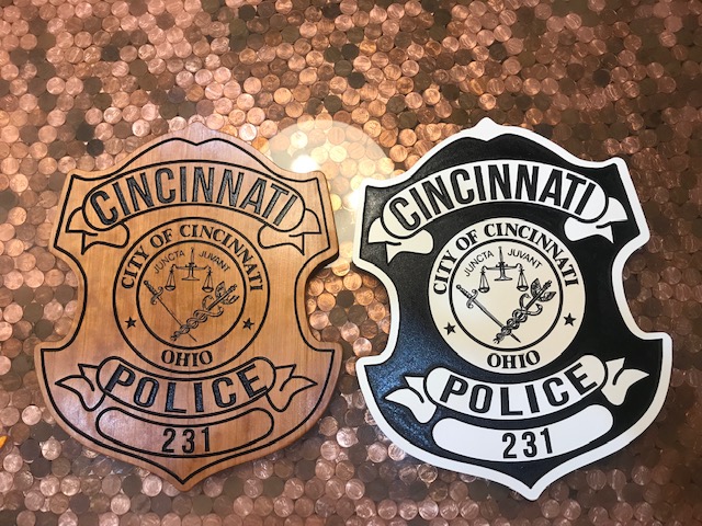

A couple variations of the Cincinnati badge I made Monday. I didn’t like some of the elements so I went back and cleaned them up for next time. Other than importing the Junta Juvant emblem everything else is Easil.I tried a couple ways of adding the dots and that crushed Easil. Going to try one using a bull nose bit as a 3rd stage in the background to give it some texture setting it .02 deeper after the initial carve.
Beautiful work!
Wow those look great.
Great work there. Been looking for a different material for my signs and found a bunch of these at Lowes. Going to run by tomorrow and pick some up and see how well it works.
Very nice and clean work. I am still struggling with painting different parts. Any tips be appreciated. But very nice work. Inspirational.

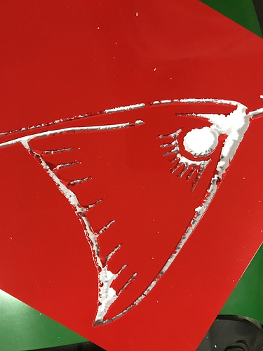

Finally got a chance to try this out with a complete fail lol… Steve are you adding some kind of Adhesion Promoter?
maybe try a downcut bit?
Good point … I’ll try that next time
I have been using 2 flute straight bits and 60 and 90 degree bits. I also have a 1/4" down cut that works good as well. I also use the Rustoleum 2X Paint for plastic most of the time as the color selection is much better. The straight Rustoleum spray works as well. Hope this helps. I have not had any do what your picture shows. I messed up one time and used an up cut bit and it chipped out pretty bad and sick to the Oramask. Other than that no real issues. I do need to find a better bright silver. The rustoleum one fingerprints real bad and scratches super easy.
