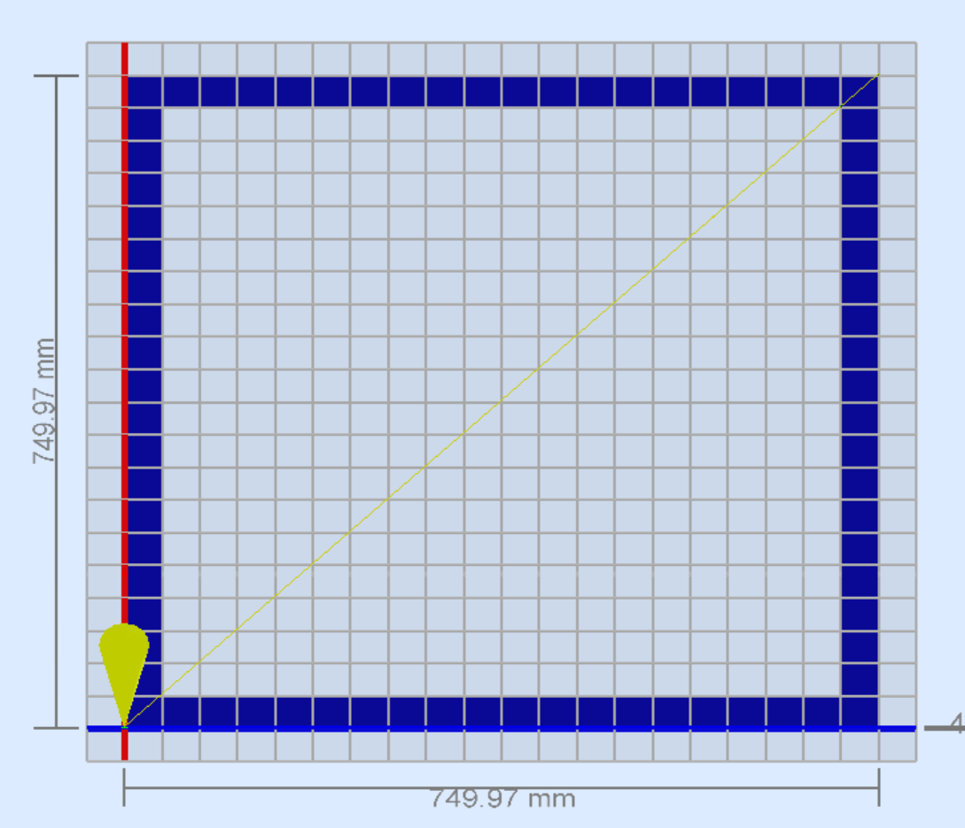

Heard it’s been buggy but tried to use it to surface my waste board and just a square with infill does this? I cannot get it to carve the entire inside…

So fixing the bit size by clicking inches actually fixed the square. This is what happens when you live up north and take the winter off of carving…

I took my skim cut project (60% step-over), moved the bit size WAY down (0.06mm) and I got this:
So my guess is this is either a Gcode line limit or a simulation artifact. So I exported the Gcode and simulated it:
Even the exported code is not a complete square. Changing the bit size to be 0.5 mm and it changes to:
Exporting that Gcode, both files contain 5019 lines of code.
Once you increase the bit size to be large enough to cover the entire surface, the amount of code (obviously) goes down.
It appears this is a limit of Easel to only generate around 5000 lines of code.
@Ruwan @JeffTalbot is this just an Easel limitation? Any other thoughts?
Hey look at that my stupidity may have actually shed light on something? Lol
Yes, there is a limit coded into Easel at which point it will stop generating tool paths. This most likely happens for combinations of stepover and bit size that are impractical. We are going to work on an enhancement to provide a better user experience and avoid silently truncating the tool paths. We’ll follow up here when we have an improvement out.
