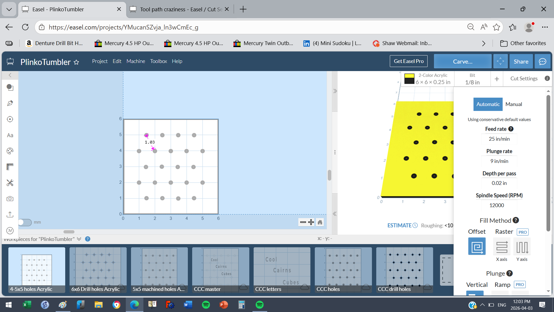

Been playing around with this for a while, now trying to get better. Does anyone know why Easel’s toolpaths jump around so much and won’t finish one area at a time? Is there a way to fix this without a ton of manual editing?

From what I can see, Easel cuts to the same Z depth of cut until it has completed the total area of the work, then starts over and drops to the next depth increment, etc. This is based on what I see on my projects, which aren’t that complicated. As Ron mentioned, you can chunk your work by using multiple gcode files for smaller areas. I think of this a modular approach where you have sub files within the overall file. Since the gcode is text based, you can copy, paste, and move things around in a text editor like Notepad. A good command of gcode syntax is handy.
I believe that to be true if cut settings is SWITCHED to to automatic rather than manual. Manual allows the use to set DOC.
