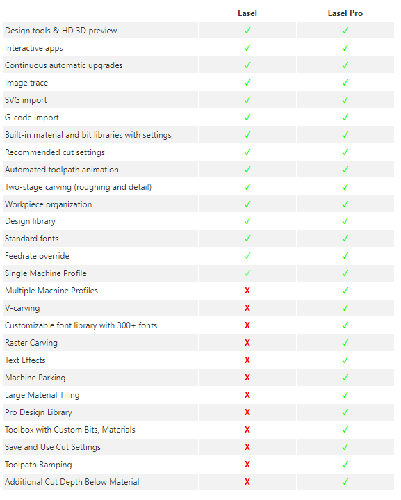

you can combine separate elements to make selection easier as a “group” kinda. . . OR you’d have to use the workpieces in order to have additional of what bit is used in what areas. . .
As far as this function is concerned, there is no additional functionality with Pro than Free.
These are the only differences between Pro and Free Easel. . .
