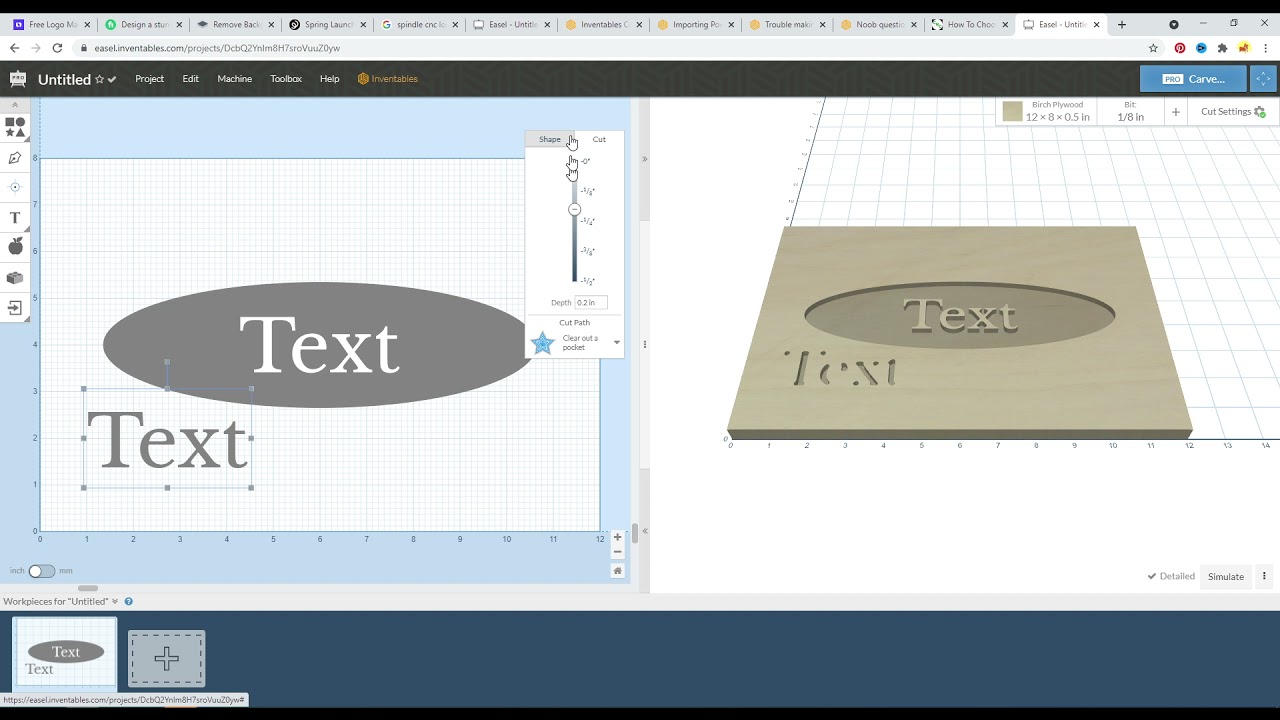

This newbie needs some help on a project. I need to how to cut out an oval but leaving a full thickness of the wood 1" border all the way around. Then I assume I will need a second oval to carve 1/4" deep from the rest of that oval. I will have text but will leave it as an 0.0" no cut. I understand how to do everything except for telling the router to do the 1" wide border and a full thickness cut on the outside edge. Hopefully you can understand what I want to do!!
Is this something like what you want to do? I created the oval and used the Offsetter app to get the Zero-depth oval and cutout that is 1" larger than the pocket oval.

Great video Seth! That explained everything.
I was screwing up the offset oval. I was checking the “inward” box. Will be testing out my “new knowledge” tomorrow.
