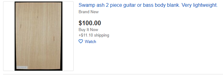

Many musical instrument woods tend to be pricey. When you ruin a 50 dollar piece of wood, you get a little nervous when you have to start over on another piece of wood that costs the same, so any precautions makes the blood pressure a little lower.
I can totally relate to that, thanks for taking the time to explain.
