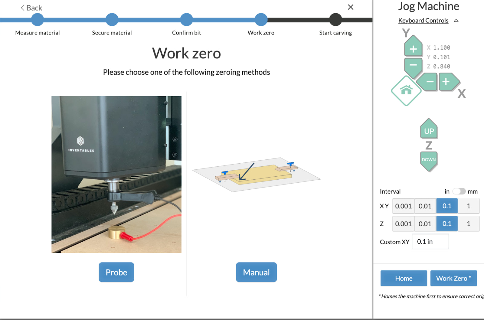

You can use the previous X/Y/Z zero position by selecting “Manual” on this screen:

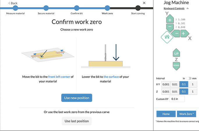

After selecting “Manual,” select “Use last position” from this screen:
Oof, that’s not very intuitive. You guys should move the “Use last position” option to the Probe or Manual screen, because I’ve never clicked Manual and didn’t even know this was an option. Would have saved me a lot of time in the past.
I agree. It is not obvious and could be better placed.
