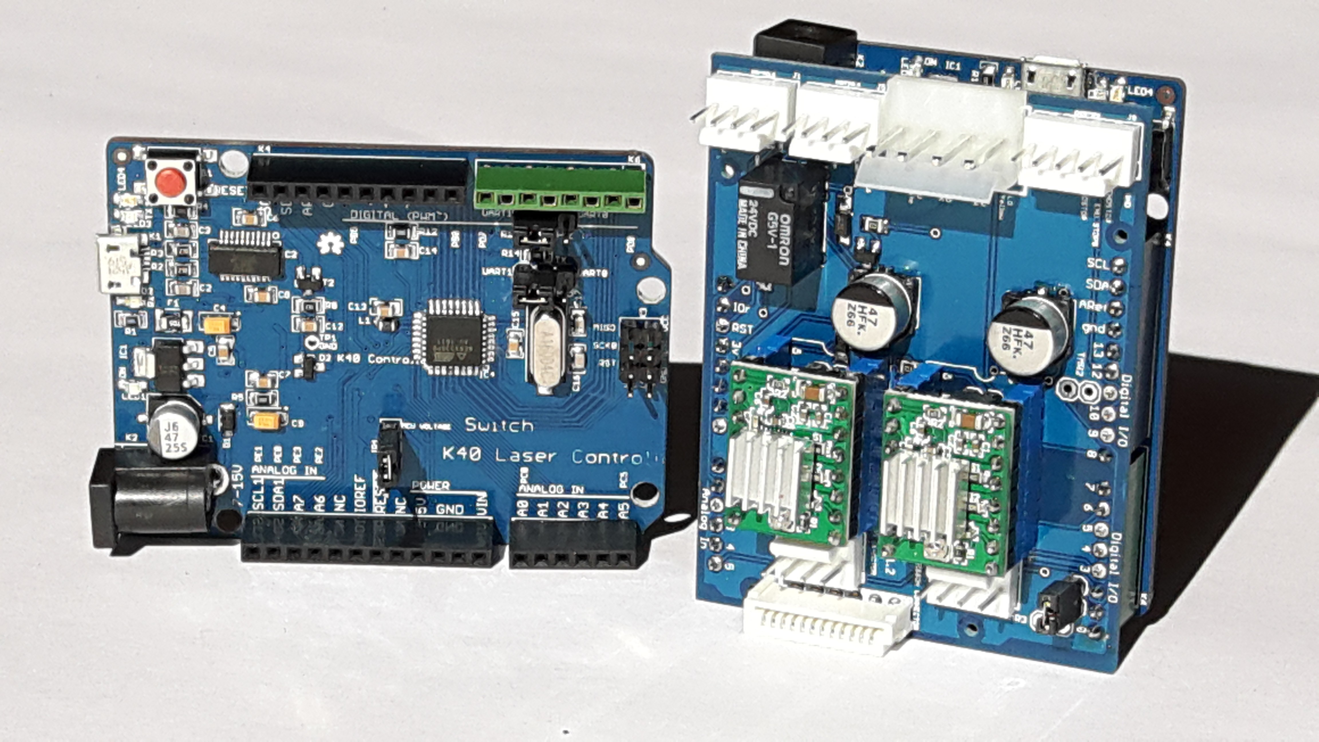

Paul is a great guy who made his own drop in replacement. He is always happy to help out even if you do not use his hardware.
