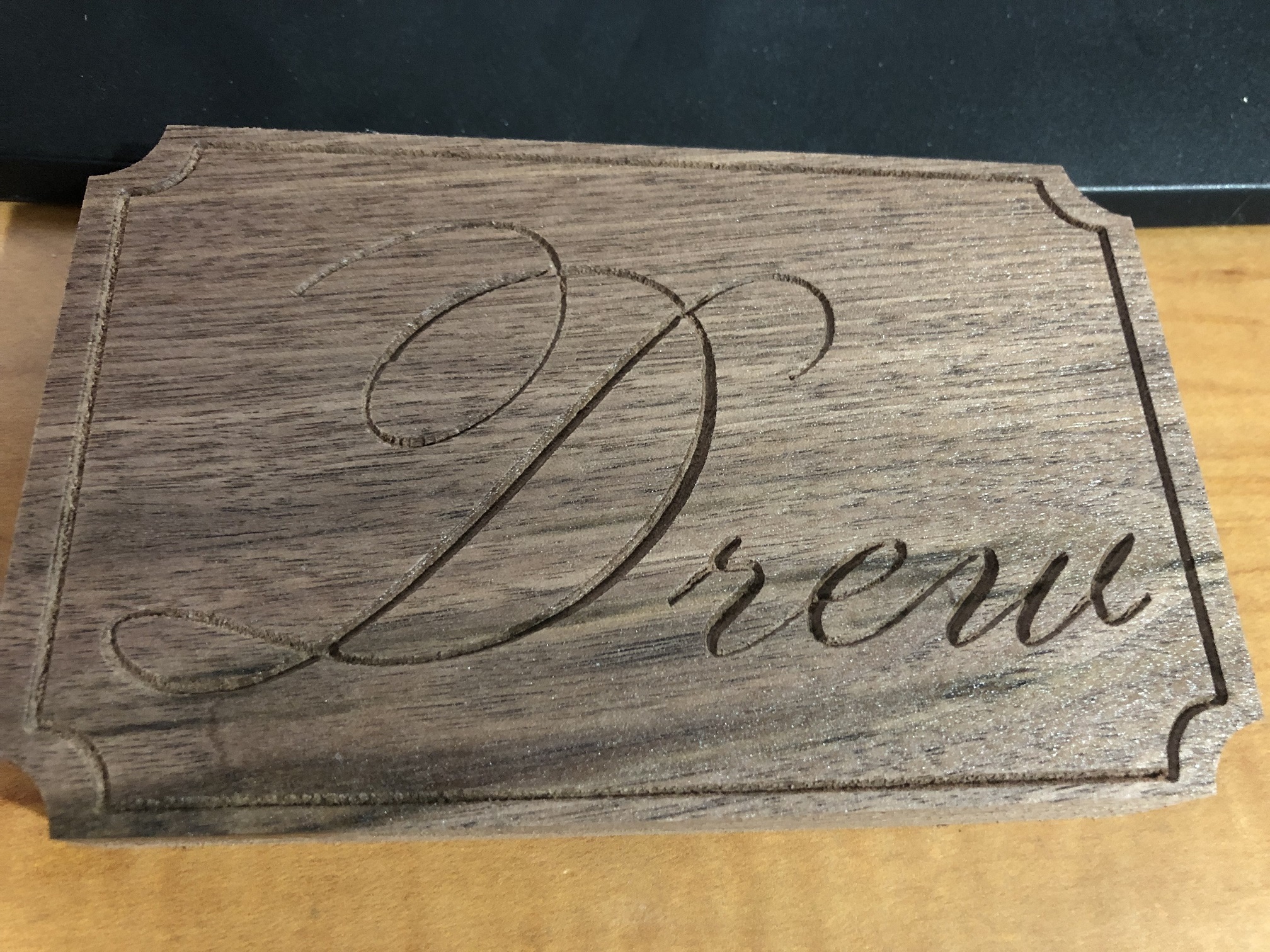

Ok, need some help from the hive!!! I am working on a plaque for a friends late Uncle. I have come up with a nice design but I am not very please with the outcome of the test piece.
For the test piece I used the Monsieur La Doula fond with a 60* bit and carved it 0.191" deep into walnut. There was a lot of clean up that had to be done in the text to fix some of the flat edges.
What is the best depth to cut at using a 60 bit in easel?*
Thank you, Drew

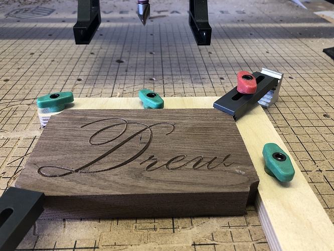

60* V Bit from Inventables
0.191 Cut depth
50 in per min
.05 depth per cut

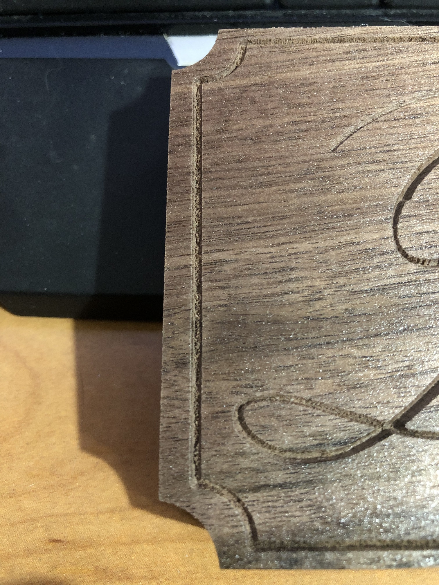

I had to clean it up a bit last night so I could show it to my friend. But there are still a couple spots that are rough. If you look on the border carve and in the loops on the “D” you will see the “fuzz” that is still attached. I had to use a 30* bit and some sandpaper to clean out the other areas to make them look good enough to present as a test piece.
Andrew, are the belts equally tight and the machine square? I see some choppiness that is indicative of a machine that is not tuned or you are running too fast for the wood/bit. Also, for hardwoods, on a stock machine, I would slow down to 40 imp.

So I have played with it a few times and I did run a second carve using the same X,Y. One thing I found out is it appears not to make a difference how deep you set it the v bit will only go so far with this particular font. (I even tried to set it to cut through and it didn’t change. Here are my results I did notice a bit of a stutter when all three axis were moving, I will have to try and figure out what’s happening there.
The depth of a v-carve is determined by the angle of the bit and the width of the design. It will carve shallower for fine, thin details and deeper for wider areas. The shape of the V-bit naturally makes the carved path wider when it carves deeper. In Easel you can set a maximum depth, but details would be lost if the bit goes deeper that it should. Try increasing the speed of the router for v carves.

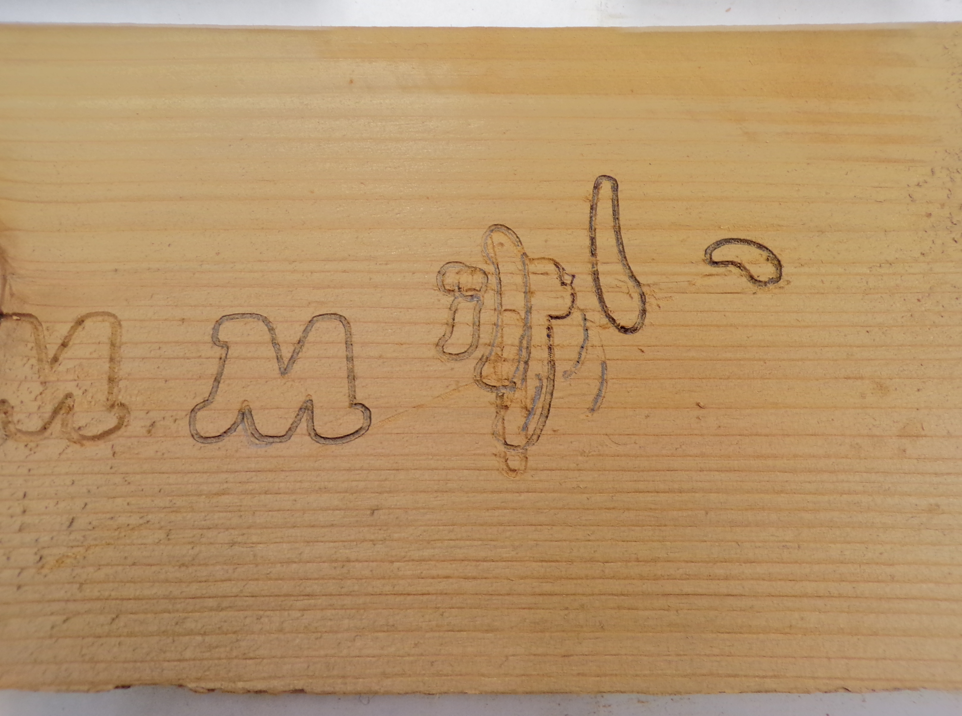

maybe you can help me here’s a picture
Whats the design intended to look like?
