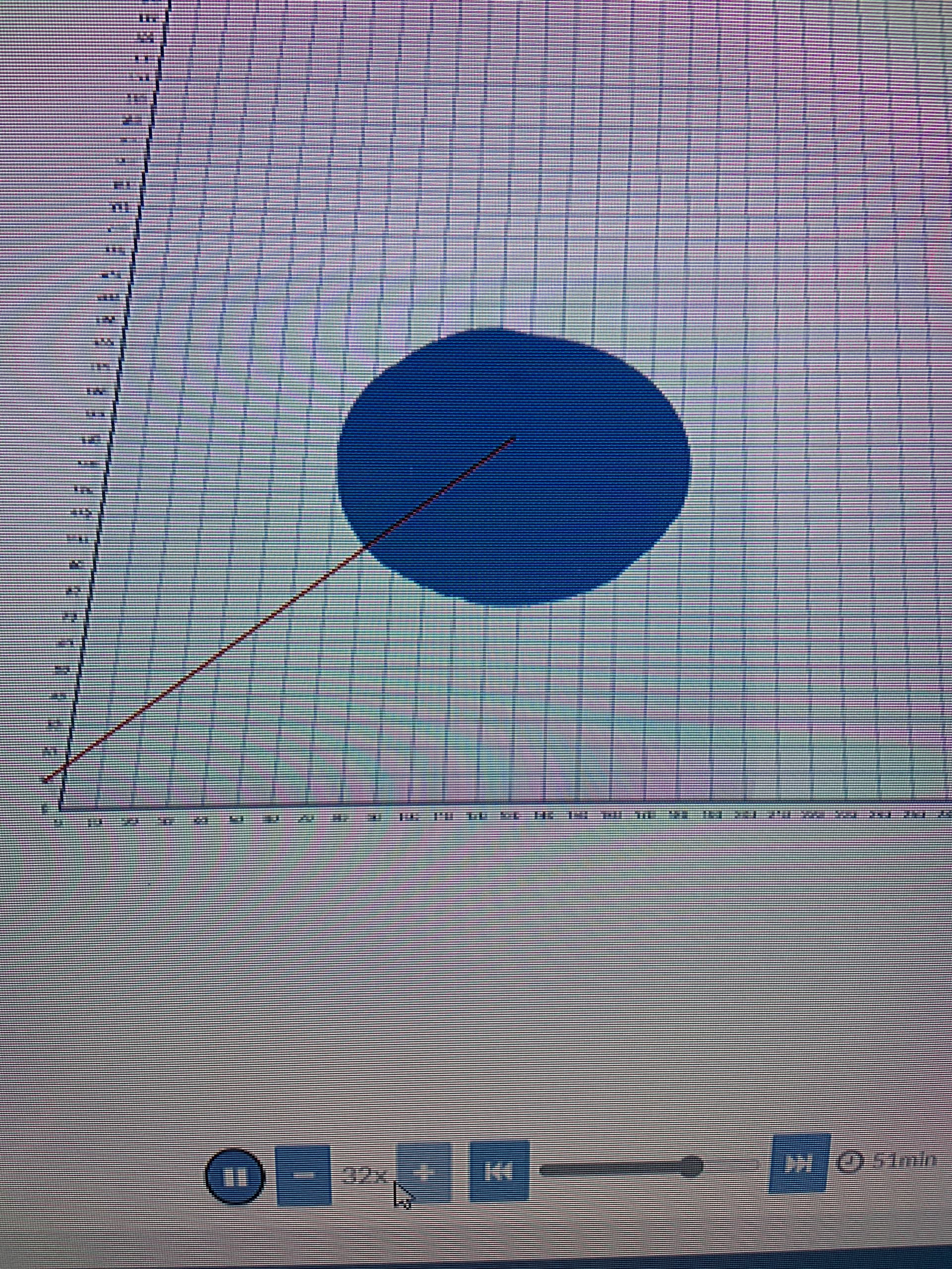

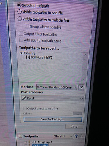

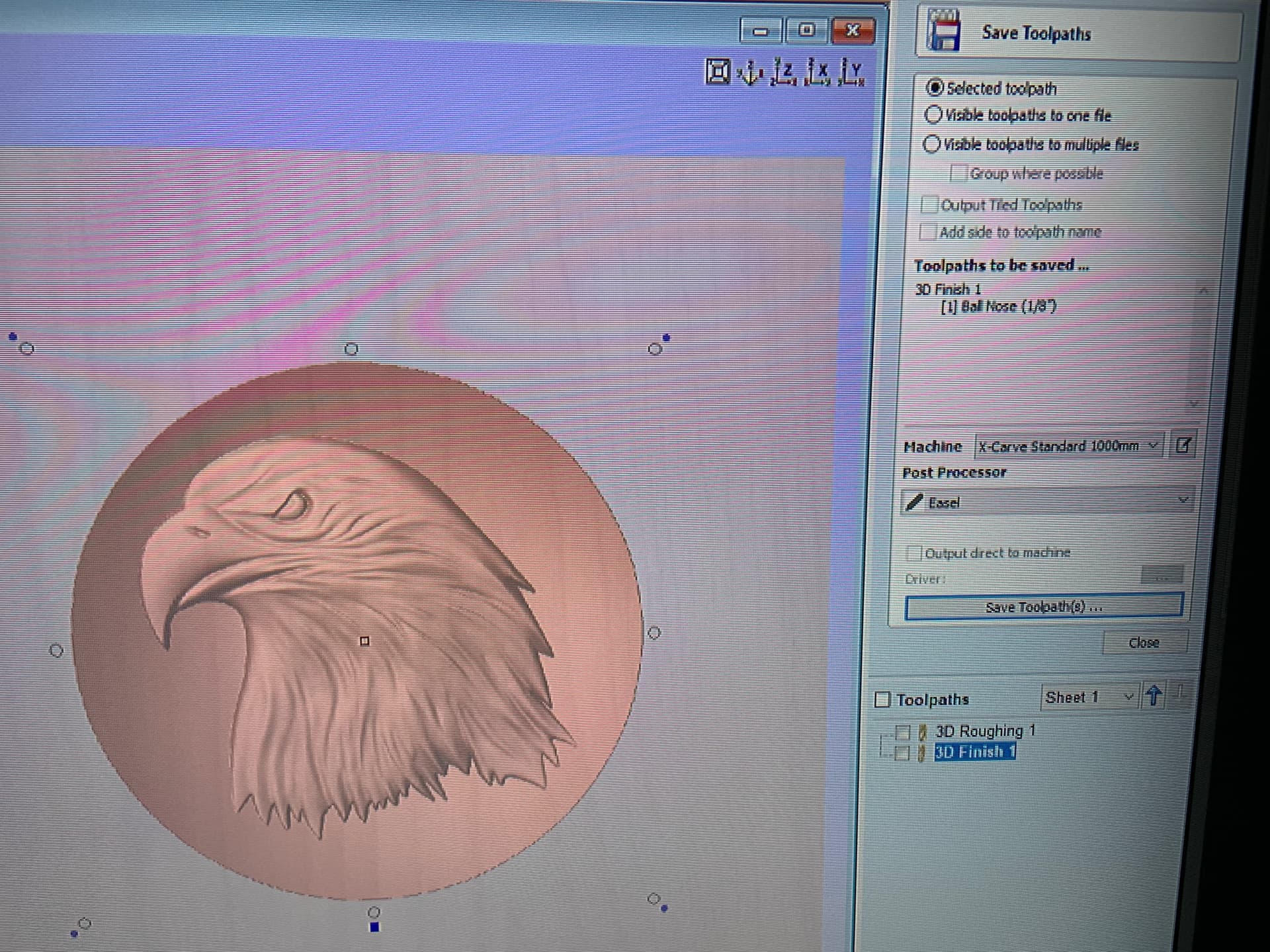

Exporting gcode from V Carve Pro and opening with Easel and it is blue, followed post processor installation instructions but nothings working.
well, if you imported a gcode you will not see an image. the blue you see is the tool path.

The blue looks perfectly normal… the finishing toolpath has riny stepovers and that reaults in a covered blue lines…
Now whether you want the location to be that far from the 0,0 position?
