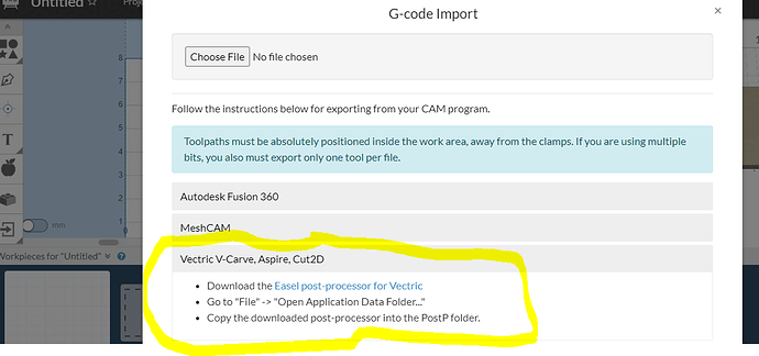

If you use the gcode import tool in easel there are buttons at the bottom that direct to the post processor download as well.
Seth,
This is all I get when I try that, and when I try to download it it just takes me in circles. I think I was able to download the Post Processor, but none of the rest of the instructions make sense.

Oh, yeah they dont make sense as they were written for prior version of vectric and with v11 vectric changed how post processors are stored and referenced and added the machine setup part as well.

As for how to get the Easel post processor into vectric V11:
Reference the second to the last step here
https://docs.vectric.com/docs/V11.0/Aspire/ENU/Help/form/post-processor-management/index.html
