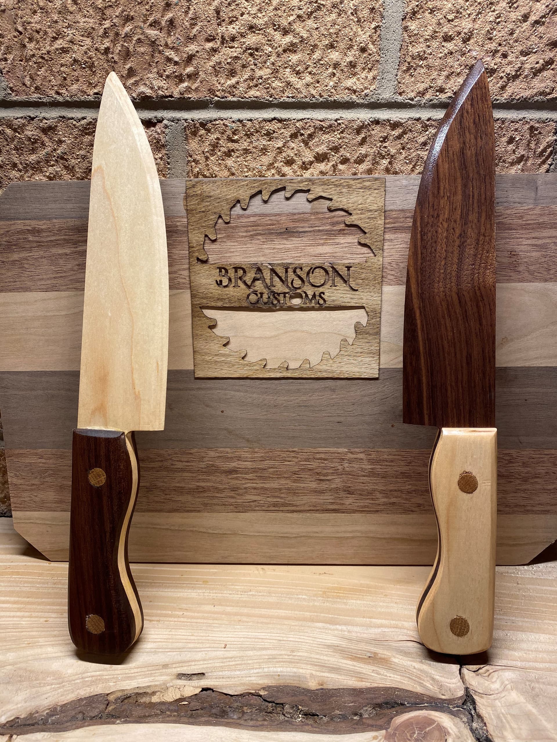

Simple but very popular project for weddings. I usually use 1/4 stock for the scales and blades. I cut the scales from a different species to give some good contrast. Pinning the scales is optional, you can just glue them on, but i like adding the dowels for more detail. I cut, glue everything up, then sharpen and shape on the belt and spindle sander.

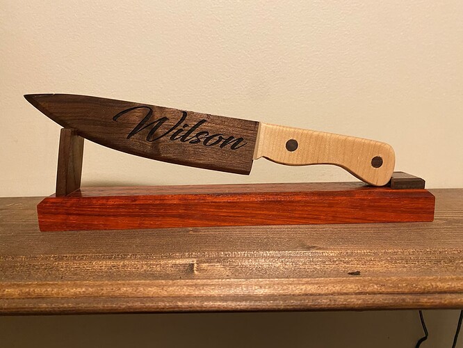

Adding the name of the couple is really nice too, i usually laser that on but could be vcarved in as well
