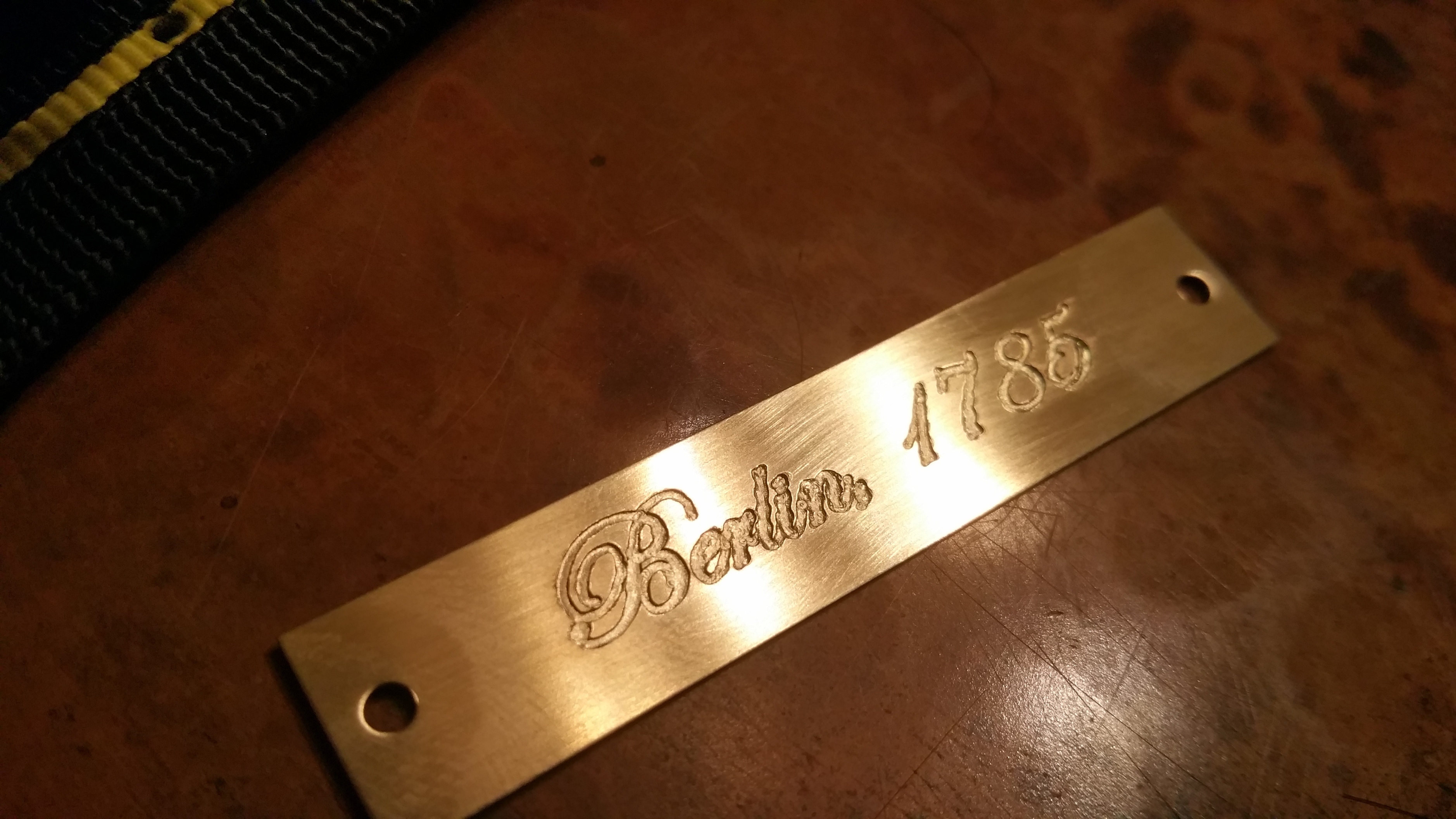

This is a great post. Thanks for your info earwigger. I have some further questions.
I pocketed the hole to make sure it was true. But with the bits you recommend I get a pretty rough outcome. Is it that the 1000mm xcarve cannot do cursive like this without stair stepping at this size? the plaque is 12mm x 64mm.

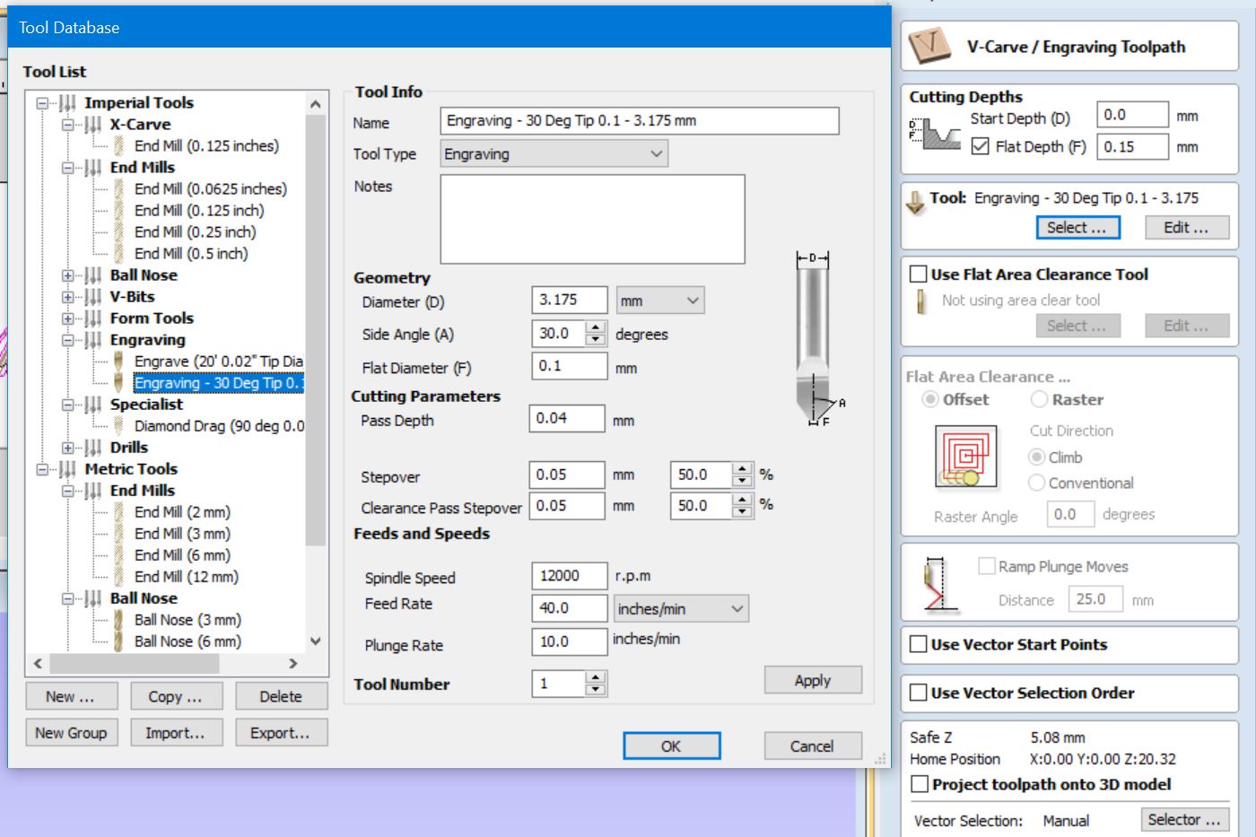

Here are my settings:

I do suspect your 40ipm is a little too fast for your machine.
Yah, something doesn’t look right. It looks like maybe your z zero was set too deep? Also, the engraving bit should not make those marks in the bottom. I go .08mm deep and it works perfectly. I would tighten everything up, add bracing, and make sure your z 0 is set to the surface of the piece.

Yeah, I am engraving to 0.15mm almost double what you do, I will try 0.08 tonight and post results, thanks for all your help!
I got some better results. How do you keep it down? I was using 3m double sided tape, but it moves around a little like on jelly, that’s probably the last thing I will work out.
