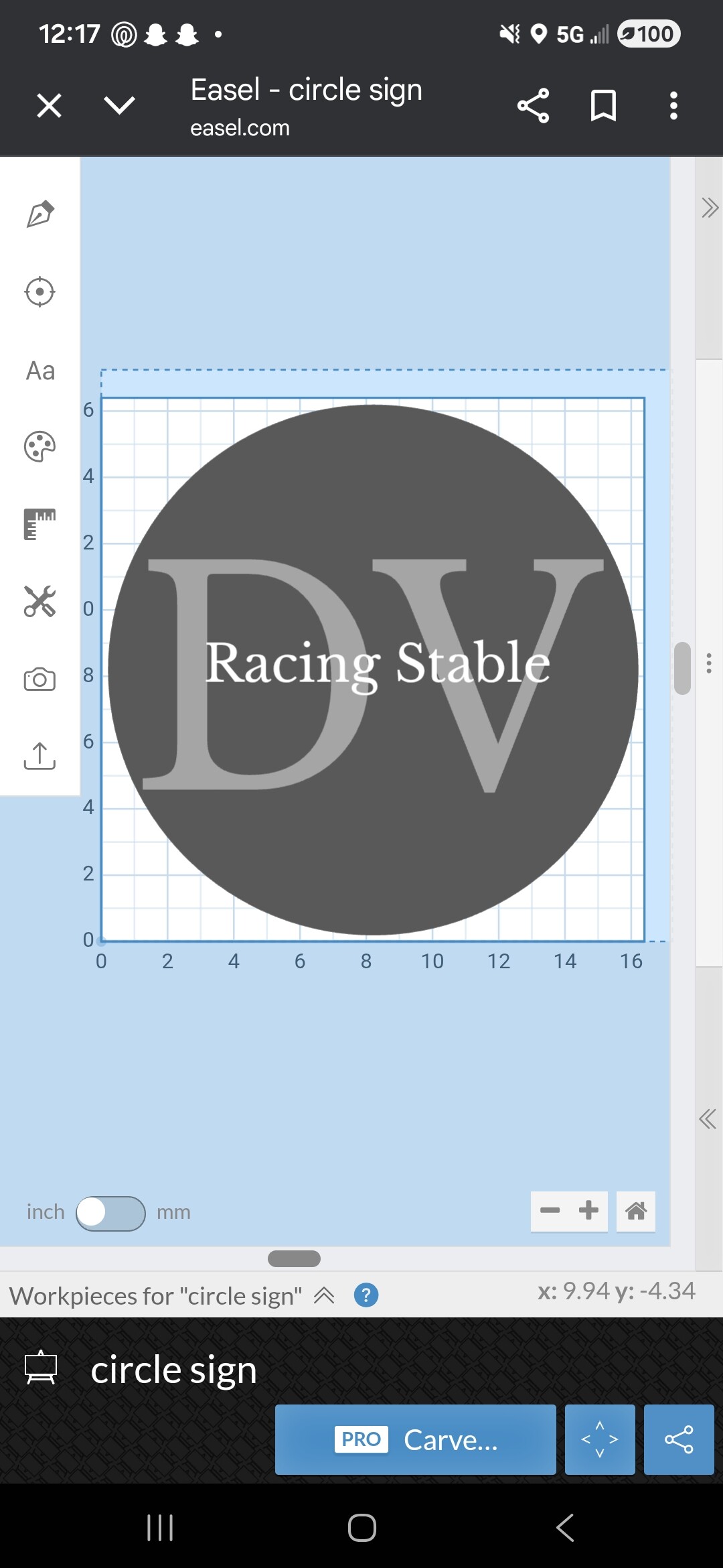

So I’m new to this and I’m trying to figure out what bits to use on this projects. Also how to speed up a project.

So right now i have the 1/8 straight end mill and 30 flute engravind bit. Just wanted to know if there was a better choice.
Your choice of bit is dependent on the object you are making. Larger diameter bits can remove more material. Smaller diameter bits can get into nooks and crannies. When you make your bit choices in Easel, you can see how bit diameter impacts the amount of time it takes for completion and how much detail can be cut with those bit choices. A 1/8" bit will have to do a lot of work and take a lot of time. If your sign is the size of a postage stamp, then it would work fine.
