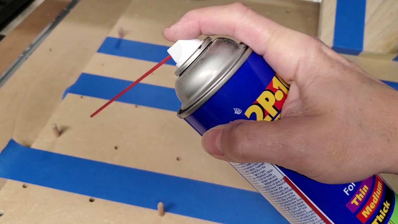

well a downcut bit will push down towards the wasteboard, which is a more solid surface vs the upcut bit pulling it up into the air. So there is a lesser chance of breakage with the downcut BUT i suggest using the double sided blue tape & CA glue method to hold smaller pieces down since the tape will also help against horizontal forces that a moving bit will also place onto the workpiece.

2 layers of blue tape, one on workpiece, other on spoilboard, ca in between to adhere the backs of the blue tape. need a clean spoilboard so blowing off or freshly vacuumed will help it stick to the MDF… and the low tac of the blue tape makes it easy enough to get off of the workpiece after the carve.

at lease someone is paying attention, just the wrong person . also using the ca method will work to hold 1/4" walnut down.
but when you go to remove from the waste board. the intricate project will break .
