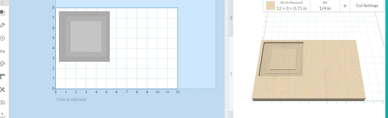

I’m not sure you can end up with a 3” square on top without cutting it at some depth. It would seem that you’d end up with the second square of 4”. I did this by drawing the squares to your sizes and using edit to send the large one to the back and the small one to the front. Then I centered them to each other. The cut depth is set individually for each square.

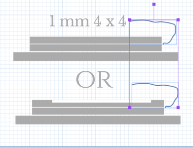

I do not understand your question’s intent. Could you send a side cross section sketch and what size is the base dimension size and height of the starting raw material? Are you trying to make a 1 mm deep pocket in a 4x4?
This is what I was looking for
sending the large one to the back and the small one to the front controls who gets cut I think I will try it. Thank you all for your replies and I’ll let you know! Tom
Draw your 4 x 4 square and set the cut depth to 1mm and clear out
Draw your 3 x 3 square and center both squares and set the cut depth to 0
Create a new cut panel from the lower panel
Draw your 5 x 5 square and match the center location to your previous 4 x 4 square. Set it to cut the outside cut and set it to the full depth.
This is a 2 cut process. First it will router out a 4” square with a 1/2” around all 4 sides of the 3” square. The second cut is on the next panel where it will leave 1/2’“ all the way around the 4” square cutting it through.
