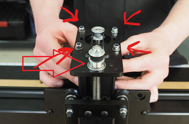

Couplers?
The thing that connects the motor shaft to the threaded rod. There should be at least 2 allen screws on it.
Grbl default settings - X-Carve - Inventables Community Forum
If you have a belt drive, it is the belt driven part.
