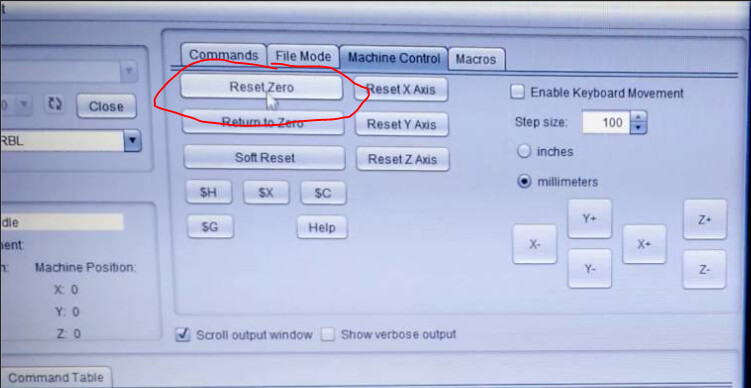

I’m running the carve using Universal G-code Sender, FYI because I don’t have internet access in my shop.
I jogged the bit to the same exact x/y location and lowered the bit to my Z height then hit RESET ZERO.
The only thing I can think is maybe an old setting is still being remembered somehow in the computer cache memory and the new program isn’t overwriting. I’m not THAT techy, I’ve just heard of situations like that happening. Other than that, I have NO idea why it’s not working right.
