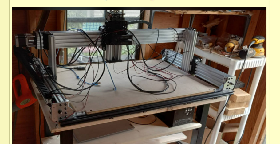

Here is my machine as it was this summer. It’s fully functional now with an X controller. I’m going to change the couplers out and square it up again. I love it.
Now my setup here allows a bit to touch the wasteboard with a 2” space under the plate. I recently ordered a double plate with should allow me to have a 3.5” tall block of wood and still touch the table.
I should say that the open builds uses wheels but a different shape from the x carve wheels. Same diameter but fits extrusion differently. Check out the Openbuilds site, as the website and documentation is still up.
