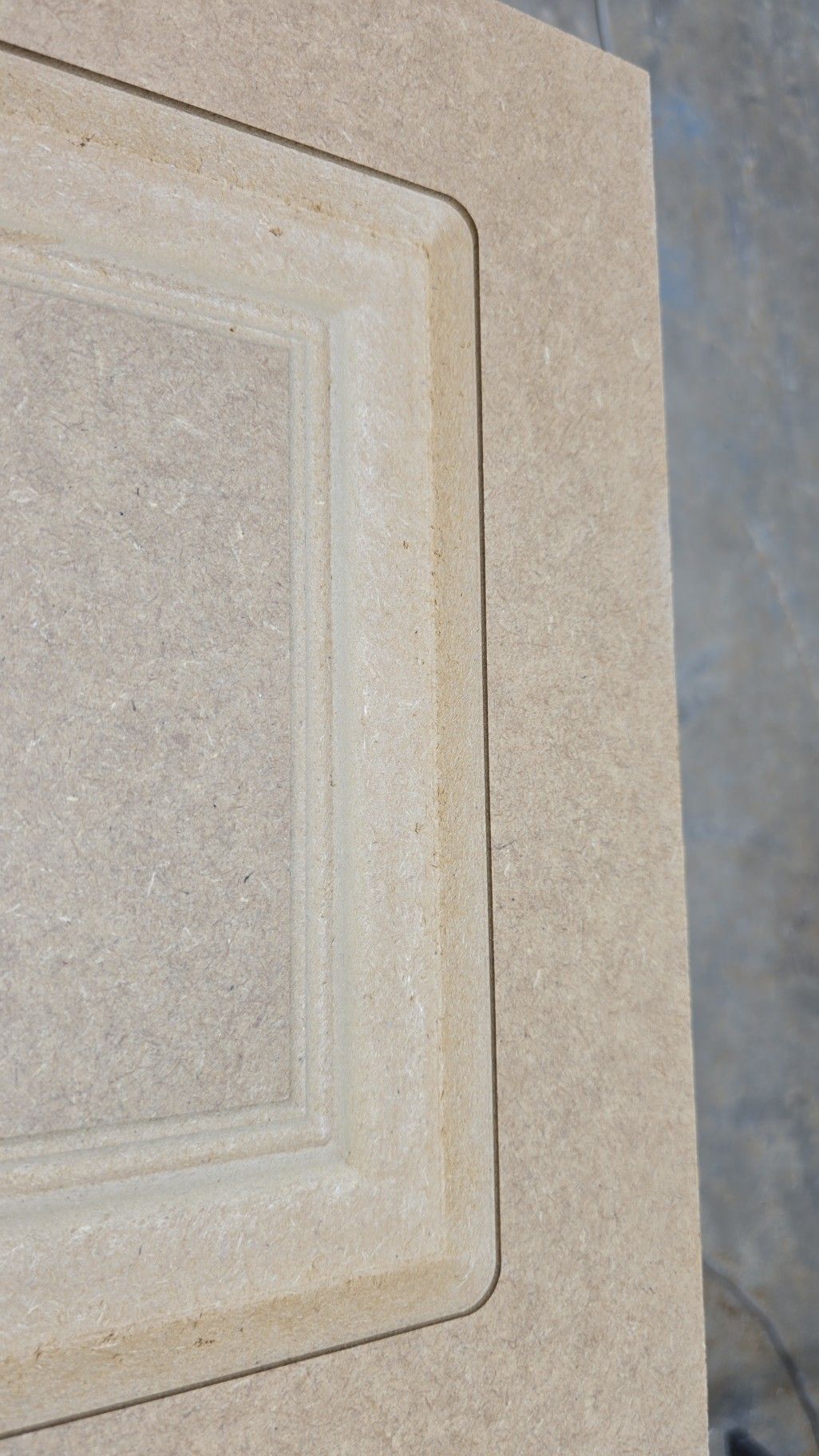

I need help how to achieve a sharp corner with V-bit on MDF Door, I am not making Shaker style door. Can anyone guide me through it please. I am using 60 degree V-bits and also what speed and feed to set it up. I do have success on MDF shaker routed door but not on regular v-bit profile.

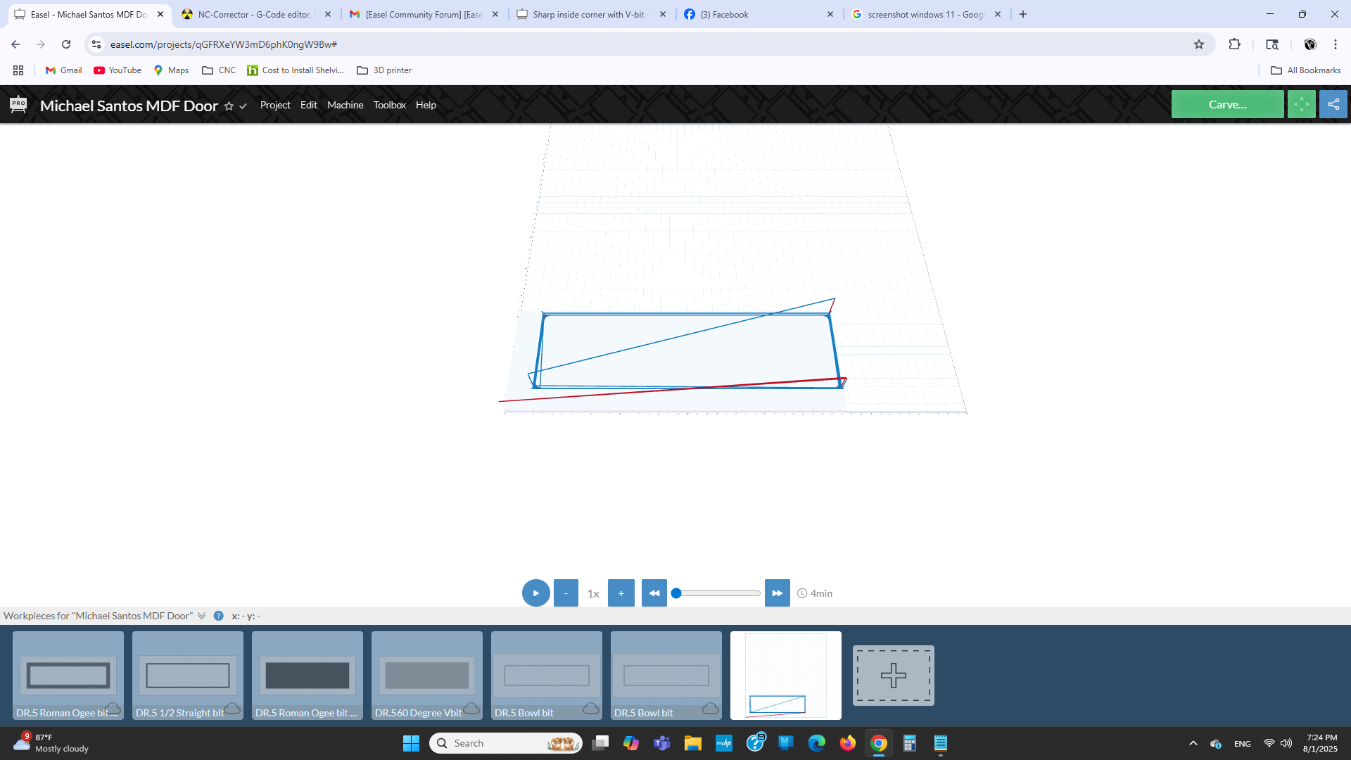

I downloan the gcode for my door project and found the code for Z axis and change the height but easel wont accept it for upload. I tried to find gcode editor tools but I have to buy it.

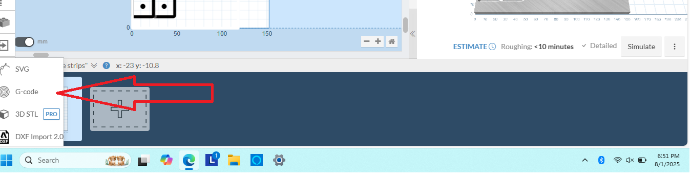

Save your gcode as a text file. You can use a text editor like wordpad or notepad to edit it. You should be able to upload it by this button:
I did that but only for stimulate mode
